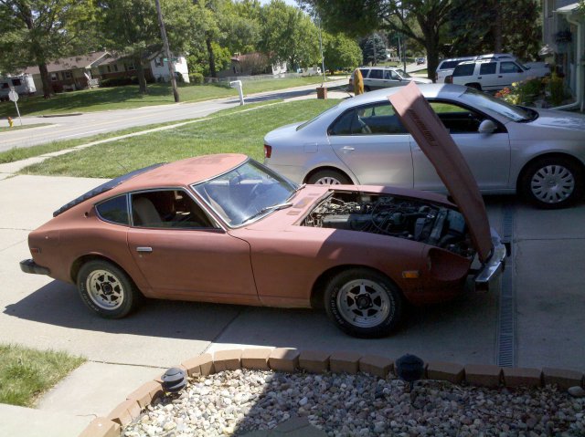

	So this past Thursday on the way to a weekend of camping I get a call from a guy who needs to move back to Las Vegas in the next 48 hours. I had left my phone # with him about 2 years ago and again in November about possibly purchasing his car when I had some $$ to "burn".....but he never called until last week. Told me he was out of work, needed cash to get his trip in order and needed to sell his '77 to fund the trip. I remembered the car but had not seen it in over 6 months as he had moved. To make a long story short, I have been off work myself for a couple months due to an on the job injury. $$ has been tight and I figured I would have no chance at purchasing hte car. After a short phone conversation I told him that I could not afford anything over a grand and if that would work for him I would come and look at the car on the 3rd. He called the morning of the 3rd and told me to come and get it so he could get on the road....now it is sitting in my driveway. The good: It runs/drives, most everything works, wiring looks to be mostly intact, very little rust in the usual places as the car has spent most of its life in California and Nevada/only 2 spots where I see any rust through on the whole car, newer 5 speed, R200 rear end, Eibach lowered 1", good wheels, newer BFGoodrich Radial TA's, all glass is pretty clean, probably not gonna need to spin this on the rotisserie to do my welding, upgraded front brakes, upgraded brake lines. The really good: I have most of the parts purchased for the swap, been waiting to get floor pans for the '73--now things will move along much quicker as this is way closer to being ready for the swap. The bad: 2 rust through areas on passenger side--rust in the engine bay next to the purge canister on the wheel well, and in front of the radiator support next to the headlight bucket, interior is shot from heat, inline 6 is very tired, car was sanded to bare metal 3 years ago and primed but never painted--this will be redone ASAP, small accident somewhere in the past as the passenger rear quarter will need to be worked/possibly replaced. The really bad: She says one of them has to go, so the car my dad left me is gonna be parted/sold/scrapped. This does not sit with me well but it is going to save me lots of $ and tons of time to work on something newer and less ate away by rust.

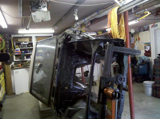

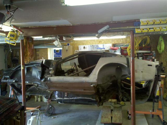

	Tested the rotisserie this evening as well. Sometime this week I will be removing the windshield and the rear quarter glass. Sheet metal floor pans will be getting removed as well, they were not done the correct way and one of them was not even primed or painted after it was welded in--lots of rust on it. After that I will get the rest of the wiring harness out of the car and try to get my neighbor to commit to a date on the mediablasting. I've decided to keep the cage in the car, not gonna need to pass any inspections as I have no intentions of roadracing this car. Anybody want to chime in on whether I should just replace the 40 year old brake lines & fuel lines running the length of the tunnel now too? Im thinking it would be a good idea but I've read both opinions on this....

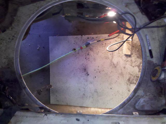

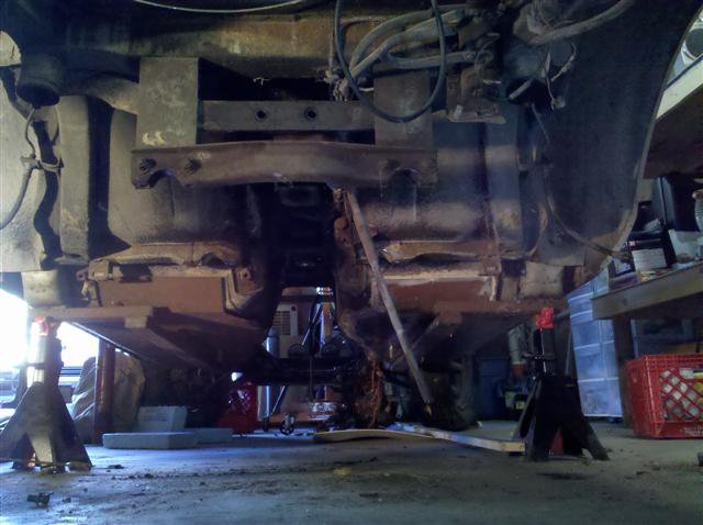

	Well I have a long overdue update.....Been working out of town and working on my house for the past 6 months.....zero time to spend in my garage working on this car. Removed the spare tire well and fuel tank then removed the rear suspension.

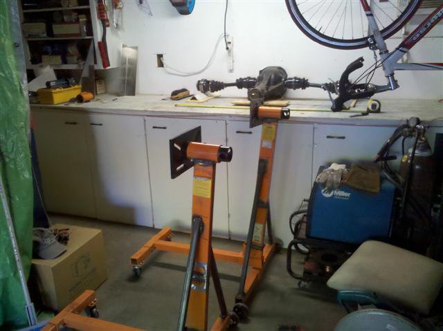

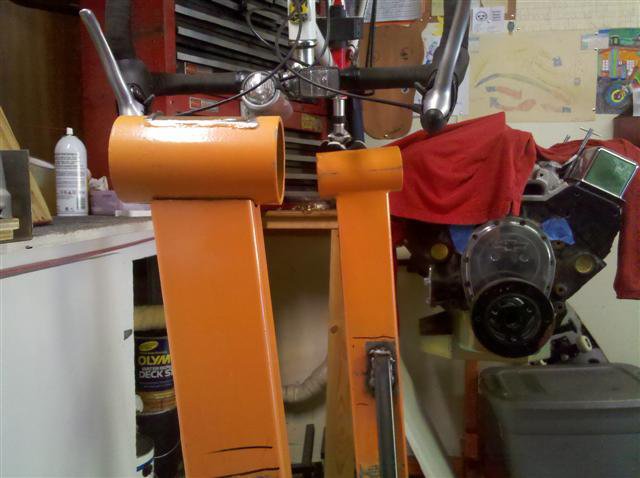

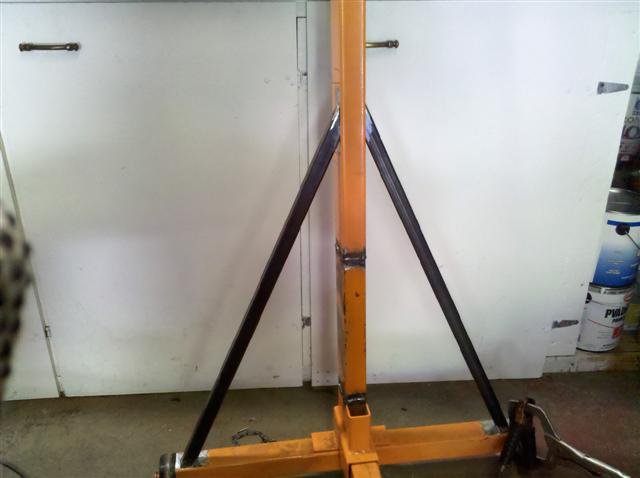

	Okay, so that was a long WEEK! Actually four weeks time has passed already....So after a broken rib and a couple of weeks of taking it easy around the garage, I finally put together the rotiserrie stands. I had to adjust the angle of the sleeves which the mounts will be rotating in. The angle was too great for my liking. Knowing there will be a little flex (towards car) in the upright when under load, I welded the sleeves a degree or 2 out of level--sleeves are just a tad higher on the side facing the car. Tomorrow I will be fabing up the front and rear mounts so I can be working on the floor pans over the next month. The third picture shows the difference in angle after I cut one of the sleeves off and left one in the original position for comparison....really shows how much angle is built into these engine stands from the factory.
