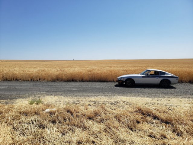

Nearly 1000 miles covered over the past few days between testing and tweaking, then driving home to see family after having nearly totally self isolated for a few weeks. I'm bold or crazy, but either way these cars were meant for driving and that's fully what I intend on doing. First fill up on a long trip. Having to be super careful since the vapor tank isn't in yet. Middle of Nowhere in Eastern Washington The ONLY hiccup along the trip. My speedhut fuel gauge calibration doesn't seem to be close enough. I also experienced first hand the wild swinging people were talking about. It's not fast, but it would go down by an 1/8th or more before settling back in! Not happy about it right now and it's making me consider going back to the stock gauge since I'm back to a stock tank and not the camaro one anymore... Home is just over the hills though, so fortunately my sister was able to come get me quickly. Whole trip went great until I was on this ramp connecting to I-15. Otherwise, car is doing great -
