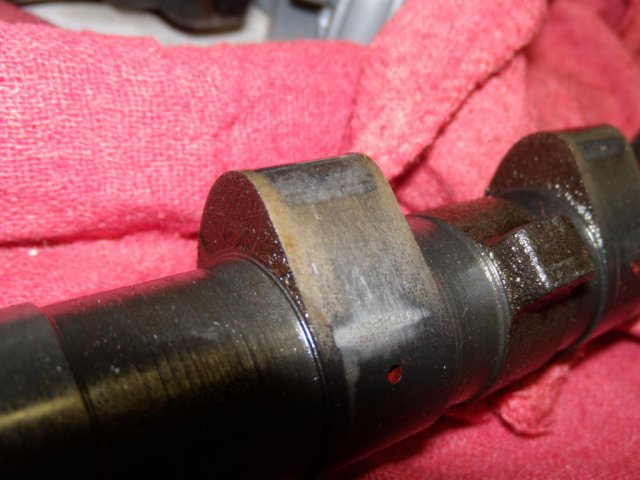

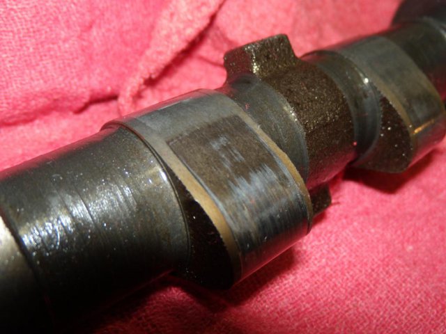

Engine woes- read on if you dare
Leon replied to madkaw's topic in Trouble Shooting / General Engine
I'll add that I also spoke with Ron about new aftermarket rocker arms. The new ones I bought earlier this year (Sealed Power brand) look essentially identical to Nissan rockers, at least from the manufacturing standpoint (2-piece with hardened inserts). He agreed that they'd work just fine, FWIW. -
Had a great conversation with Ron at Isky last week. Got some enlightening information out of it. Ron recommended either using new rocker arms or even reusing used rockers as long as they're in good shape, i.e. you can't feel a ridge at the ends. We discussed rocker arm prepping and regrinding, and how difficult it is to actually get them right. He absolutely did not recommend sanding them which I had done based on a recommendation from a very good source. As far as grinding goes, we discussed the difficulty of properly fixturing rockers in order to regrind them. I mentioned how surprised I was at the cost of Delta's regrinds and Ron said that he would expect it to be at least $6-7 worth of work to properly regrind a used rocker. It's been proven, in my mind, that Delta does not fixture the rockers precisely. I'll try to give Delta a call to discuss their procedures but I'm not expecting them to give me much thought because I don't think they make much money on regrinding these things. In the meantime, Ron was able to actually fix the wiped lobe but since I sent another cam core in, I had him grind that one too as a backup. Finally making some progress here!

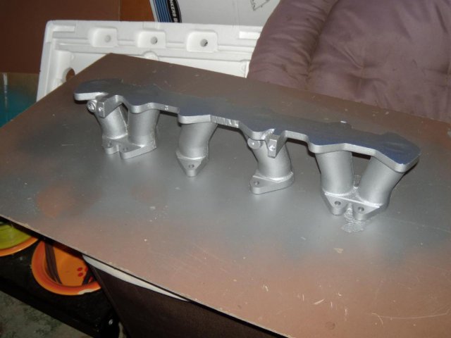

On another note, I had some time to paint the TWM intake that I plan to swap in. Paint color is "Cast Aluminum" so it didn't really change the color of the part much but I wanted to do it because painted parts are easier to maintain than bare metal. I also decided to take some measurements for the sake of documentation. The Cannon roughly measures about 145mm/5.7" long while the TWM is ~106mm/4.2". That's a 1.5" difference in length, more than I expected! This is nice because it'll open up some room between the air horns and inner fender and master cylinder. I just ordered 3/8" phenolic carb mounting blocks which will extend effective manifold length to just over 4.5".

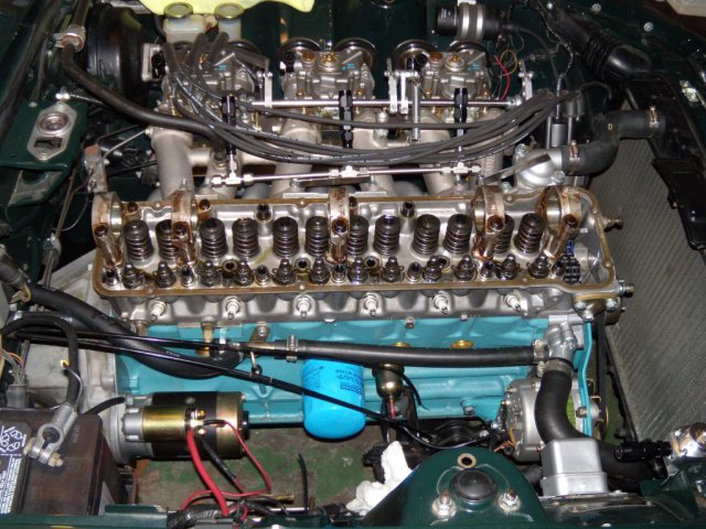

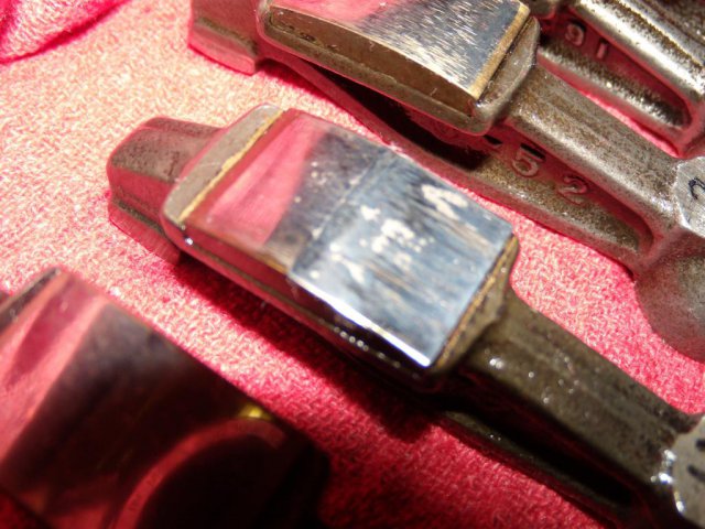

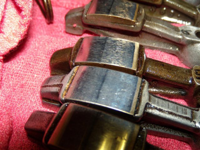

It's not an oil flow issue, there was no discoloration indicating excessive heat buildup. Furthermore, when initially priming the new engine I peaked through the oil filler cap hole in the valve cover to watch for oil coming out of the cam lobes, thus I know that the oil at least gets up there. Upon removal of the valve cover, the valvetrain was covered in a nice film of oil. The cam is an Isky regrind on an OEM cam. The rocker arm that failed in spectacular fashion was a home-prepped one but upon closer inspection there are signs of premature wear on a few arms, both home-prepped and Delta reground. Defects like small chips on the wear surface. At this point, only one rocker really failed but I can't say how long the others would've lasted. I bought new rocker arms from Rockauto, they are Sealed Power brand. We'll see how they hold up. I have not contacted Delta about the problem. At that time, I was in a rush and was not interested in extra headaches. Things just had to get done.
Oil wouldn't have made a difference, it can't fix poorly prepped rocker arms! For the record, I used Brad Penn break-in oil for the initial flush and the first ~250 miles before switching to their partial synthetic 10W-30. This was recommended to me by Ron Iskenderian. The cam was already wiped by the time the 250mi oil change came around. The oil change was done in San Luis Obispo on the way to JCCS so the parts you see in the photos have something like 1000mi on them.
