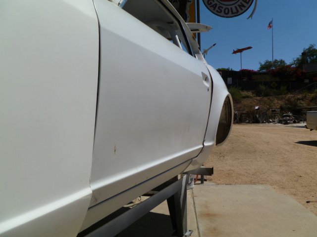

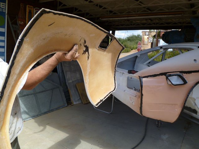

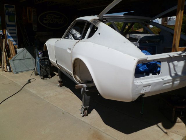

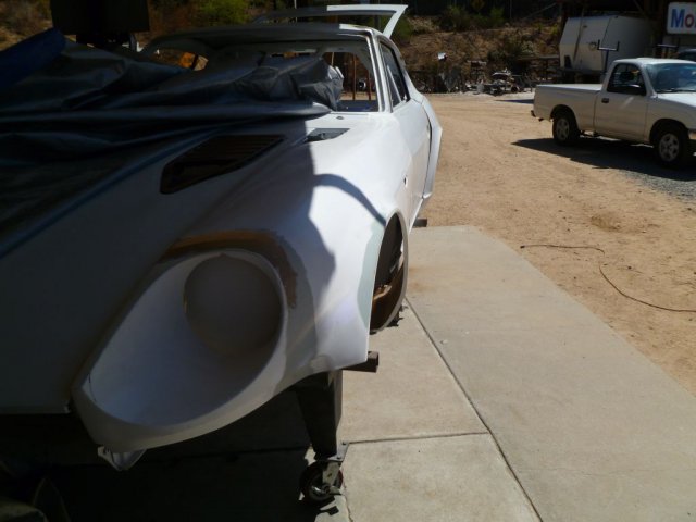

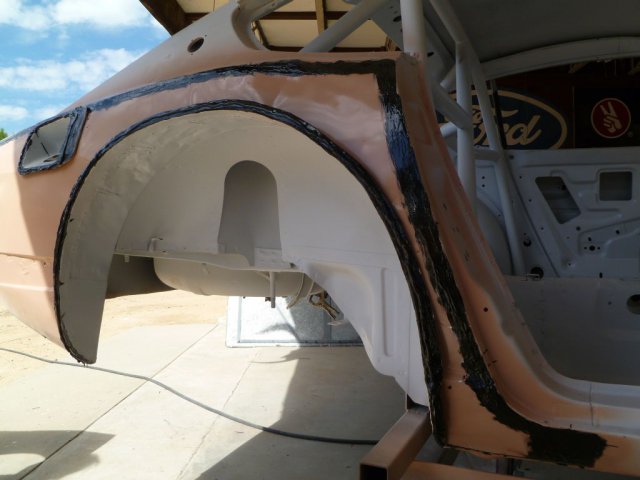

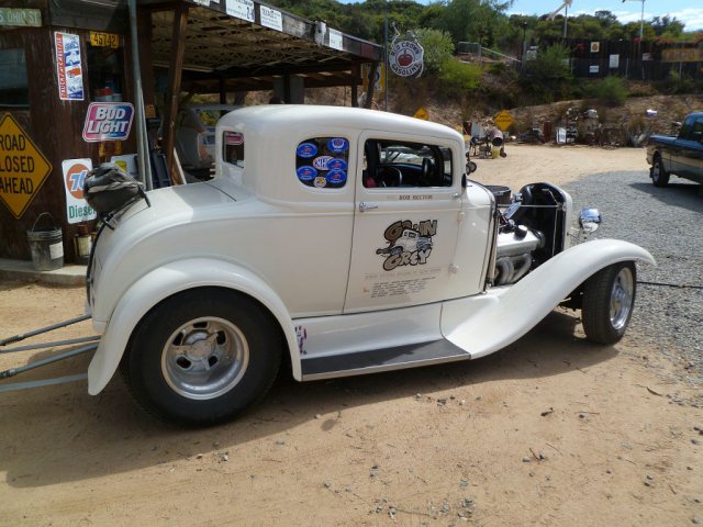

Some minor progress this weekend. We painted the rear body panel on the inside of the subtlez panel for complete coverage. We ground the area for applying the 3m adhesive and finally bonded the rear quarters on. We just barely got by with two tubes of the 3m adhesive and then started on adjusting the front passenger side. Lots of cutting/grinding will be needed to get the panel gaps acceptable. The last pictures show the hood and drivers side just resting and not bolted on. She is finally somewhat taking shape. Bob the property owner rolled up in his coupe with a 406, while I was there working today, so I snagged a few shots.

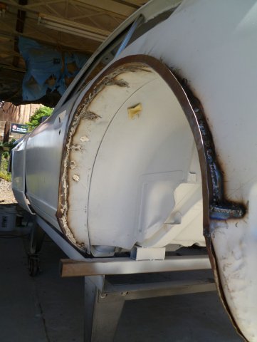

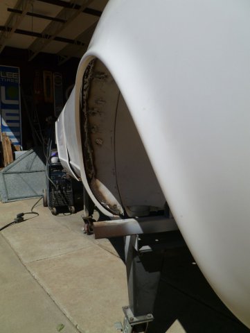

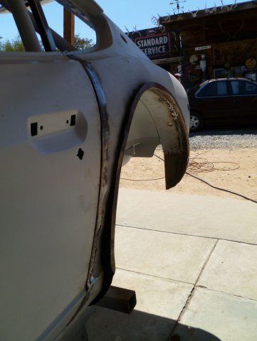

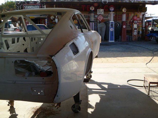

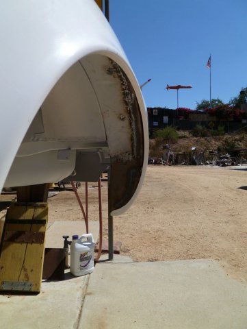

Finally a little more progress on getting the rear subtle z 1/4 panels to fit the body. The body guy Stuart as well as myself only get a chance to come out to the car on most Saturdays to make a little bit of forward motion. He welded a new lip/support for the fiberglass 1/4 panel to rest against in an attempt to eliminate any flapping or movement the panel might make while at speed. He slightly pushed out the lower part where it connects to the dogleg upon my request. We will have to split down the waistline to fix the "bowing" effect it puts on the rest of the panel. He welded in a new extended wheel housing metal piece to fill in the gap as well. The whole underside will be undercoated when the time comes for it. The last thing he got around to, was removing the factory lead in the upper c pillars to eliminate a flex/stress area. When it is all done with welding, it will get blasted again by Bob and primed again to cover the metal. Upon catching up with Bob Rector the blaster, owner of the property and gracious host,as he was working on his race car he informed me that he managed to get three warm up runs at Bonneville before something let go in his tranny. He ran a 155 warm up, 190mph and lastly 194mph with looots left to go when his tranny let go. He is working on the car now in preparation for El Mirage.
