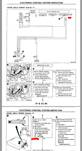

All of the plugs are white. There's a bunch. Might be one of these. Nissan draws the correct plug shape in their diagrams. The full size diagram has wire colors.

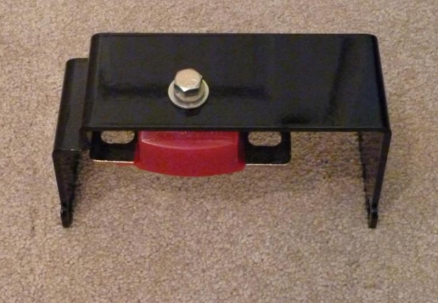

You can tell if the diff is right because the half-shafts will be perpendicular with the wheels. You can shim the GM mount downward to get the right angle. With the KA transmission (71C) the short propeller shaft will be correct. You moved the diff back, so the shaft needs to be lengthened, not shortened, to use the stock transmission. So an RT mount with GM mount, shimmed downward, and the short propeller shaft with a 71C swap should get everything right.
Not used. "Control unit checking terminal". They just hang there and confuse all of us that run across them.
Might be easier for you to just get the GM transmission mount and hang the diff from your Technoversion R/T mount. Even with the snubber you can still get some thumping as the diff nose moves up and down. But you might have a new problem, in that your propeller shaft is not as engaged as it was. It's pulled out of the transmission by that /12 inch you mentioned. Better check spline engagement.

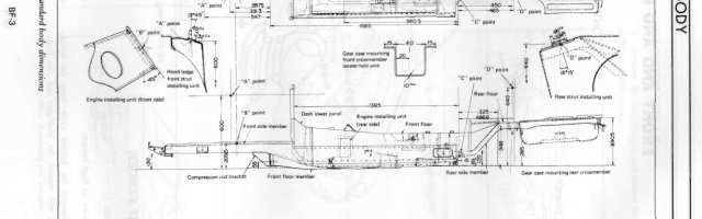

Put the old one back on and see if you still have the problem. Compare the old one to the new one. Check the body chapter for dimensions.
