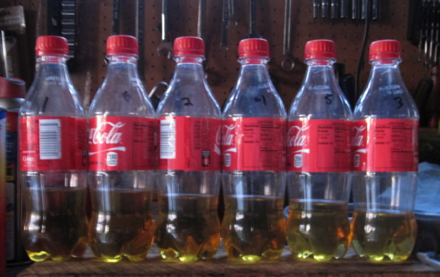

Vacuum leaks tend to be most significant at low air flow. At high RPM there's so much air going where it's supposed to go that the small leaks become insignificant. You could have the injectors tested pretty easily. Here's a shot of some flow test results from injectors I had on my 76 that actually ran pretty well. I tested them myself at full flow rate. It ran a lot better when I got a matched set on it. If you're handy you can figure out how to short the injectors at the ECU and let them squirt. Pop the rail with injectors and give it a try. Beware the gas fumes and sparks. -
