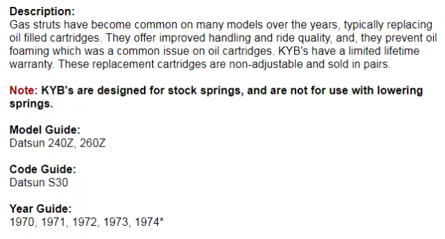

Isn't the "cooling fluid" thing just a myth. Some strut manufacturers recommend against it. https://www.kyb.com/knowledge-center/shock-tech-for-pros/installation-tips/strut-cartridge-installation/ The same struts are often spec'ed for both 240Z and 280Z. The difference is the length in the back. https://www.rockauto.com/en/catalog/nissan,1978,280z,2.8l+l6,1209260,suspension,strut,7584 https://www.rockauto.com/en/catalog/nissan,1972,240z,2.4l+l6,1209169,suspension,strut,7584 If a person considers the basics of what the gland nut does when a cartridge is used, things get simpler. It just centers the cartridge and applies clamping force. Shims and collars can be sued to make gland nut cavity smaller, or a lathe to make it bigger. Just some thoughts. It's just a shock absorber in a tube if you use the original strut tubes. -

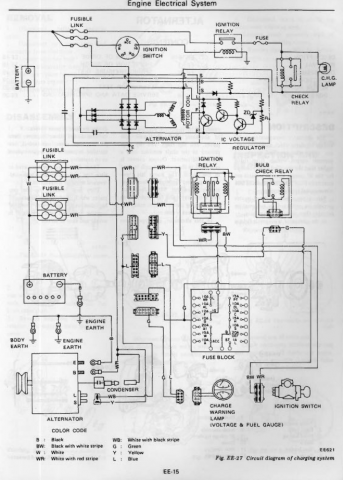

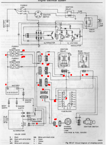

That makes sense. I just checked my 76 diagram and it has those two sources for the L pin power at the alt also. Didn't realize that. Thought it was just the Charge lamp. Still doesn't explain why the Lamp (Charge light) in the meter doesn't power the L pin at your alternator. You might find that things work but you'll be missing the Charge light. One thing at time. Good luck. The burnt relay isn't too surprising. I've found one burnt one on my car, plus one that was a pile of rust inside. -

Seems right. 30 and 87 are the power for the device that is being controlled, B and GY. 85 and 86 are the circuit that does the controlling, G and L. Yes, L would ground through the alternator. So that could be your missing L wire power, although there's supposed to be a second circuit, through the charge lamp. I'm not sure that diagram is right though, as you thought. Seems off. What bulb is being checked? The bulb check relay could be your whole problem. Good luck. -

You're not really grasping the basics of electrical circuit troubleshooting. There is a path that the electricity follows. Use your meter and follow that path until you find that point that has no electricity. You don't have to hope or guess. It will be yes-yes-yes--no as you check the critical spots on the path. You probably left a connector unplugged, or mixed two up. The shape of the connector matches what the diagram shows. The tachometer diagram shows the position of the connector in the relay panel. Poke-read-poke-read-poke-read.... Edit - the case of the alternator needs a good ground. It should ground through the mounting points but there is also a dedicated ground terminal, the "E" post. Check the ground. With your meter. -

The tach, the charge lamp, and the check relay all get power through the ignition relay. The ignition relay power comes through a fusible link. -

Do you not have a hand held meter? To use for measuring voltage? When I posted the wiring diagrams I thought that you would see the circuits and check those. Didn't know you'd remove the dash to change the bulb first. Anyway, the diagram shows that power to the check relay and the charge lamp comes from a single fuse. You might check that one. 10 amps, 4th down on the left side. Edit - I see that you said the fuses look fine. But you should be using your hand held meter or test light to confirm voltage, on both sides of the fuse. If there's no voltage at the fuse, follow the circuit backward. All the way to the fusible link. The location of the relays is in the Body Electrical chapter. -
