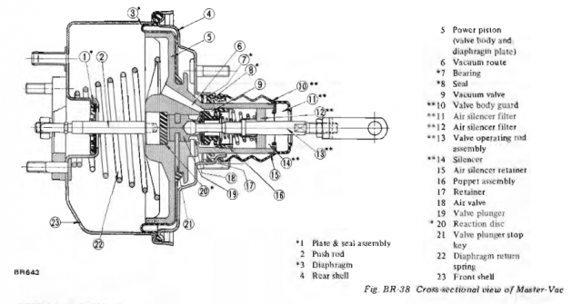

The drawing in the Brake chapter allows you to see the line of force for the mechanical parts, all the way to the MC. You need to get all of the play out of these parts before you start worrying about the hydraulics. You're wasting brake fluid otherwise. You're jumping around from booster to caliper to bleeder to NP valve. Just follow the path from your foot to the MC piston. -

Start at the pedal and figure out how each piece works. You're talking about the booster but nobody uses the booster when they bleed the brakes, it doesn't matter. Nobody has the engine running. You haven't confirmed that your pedal play is correct, as described in the FSM. At this point, by your description, it sounds like the brakes work fine but the pedal throw is too long. That sounds like a simple clevis adjustment at the pedal. Study how the pedal presses on the rod that presses "through" the booster to the MC. Make sure that all of the mechanical play is set correctly. " (the pedal get firm at the bottom and does not go to the floor). The problem is still that I get a lot of travel before much happen. " -
