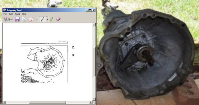

Any idea what this transmission is?
NewZed replied to D9inger's topic in S30 Series - 240z, 260z, 280z
Kind of looks like a VG30 pattern except for a missing hole or two. This is from the 1995 Pathfinder 71C transmission. They look about right along the top. Clutch and fly wheels interchange to a certain extent from VG to the L series engines. -

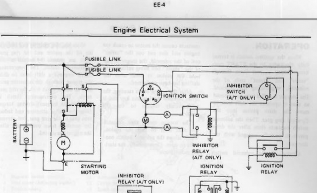

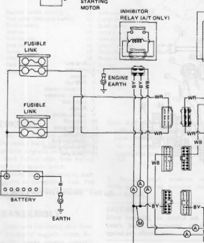

Zhoob's link will have the wire colors. If you want to be sure. I think that the inhibitor switch is at the shift lever or on the transmission. A neutral switch. The diagram might show location, or the transmission chapter might show the switch. -
