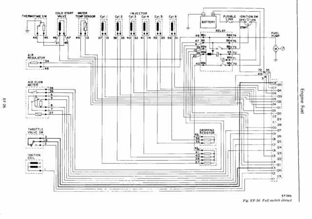

76 has electronic ignition. Engine Electrical. You didn't say how the spark looked. The fact that the injectors sprayed while cranking indicates that the coil was discharging. That's what the ECU uses to know when to open the injectors. Go to the basics of what's supposed to happen. If the cylinders suck in some starting fluid and there's a spark you should at least get a pop. Something's missing. The details are important. You didn't describe the spark, and you haven't said how you sprayed the fluid, just "in the manifold". You might be spraying in to an electrical plug. Who knows. Thinking about replacing the coil without testing it is a bad sign. The beauty of these cars is how much testing information is on the internet, free to anyone that want's to use it. You could have had the whole system tested by now, with a meter and one of those books. Just saying... -

How do you know the injectors were firing? That's the part you just worked on so the most suspect. If they were squirting and you have dry plugs, there's a logic issue. You can see the disconnect there. Is the spark strong and bluish or weak and orangish? Sometimes you can get spark in open air but none under cylinder pressure. The old 280Z ignition modules are failing at a pretty regular rate. If random actions fail you could start at the basic troubleshooting steps described in the FSM and the Fuel Injection Guide. The 980 Guide covers all years up to 1980. http://www.xenonzcar.com/s130/other.php -

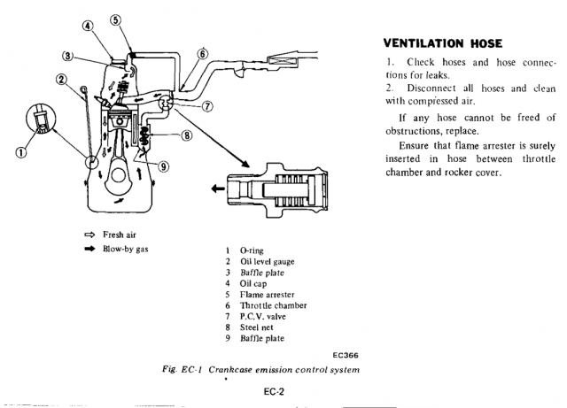

Unintended consequences. You can either put the system back together or block it completely. It actually keeps your oil cleaner, and your engine bay. Removing parts that aren't understood is a common problem source. -

Open that FSM chapter. It's not as hard as it looks, it really isn't. You're just hacking around until you do. Y'all people are every where. Hack, hack, hacking away - http://forums.hybridz.org/topic/125532-wont-start-after-fuel-rail-upgrade/?do=findComment&comment=1173508 http://www.nicoclub.com/FSM/280z/ -

I just took a second look at your picture and see that the PCV hoses are gone. There's your problem. Put the PCV system back together. Google "280Z PCV vacuum leak". Read the Emissions chapter. It's all there. -

Are you figuring things out on your own or did you use the testing procedure in the Factory Service Manual? Page EF-54. The AFM switch is a common problem that can confuse people not familiar with how the system works. Those relays are hard to find but they've been seen on eBay. There are also a few places that sell replacements that work. http://www.zcarsource.com/fuel-injection-relay-280z-280zx-300zx_8_56767.html https://www.summitracing.com/parts/bck-203-0053
