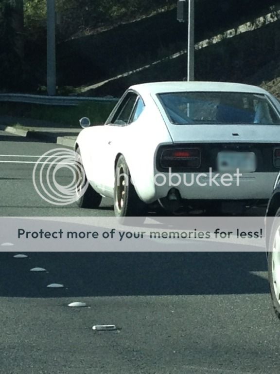

alex.cecil89 Posted March 3, 2014 Share Posted March 3, 2014 I have been trying to learn the dang offsets for the different size wheels and widths for these s30's and cant seem to get rid of the headaches i get from trying to figure this all out. At first I thought the more negative you go, the further out it sticks, then a friend told me i was backwards, and now I have given up. I have zg flares on the way to the house, wont be installing them until I get rims and coilovers installed. I want to go ahead and get wheels now because one of my rims has a little dent in the edge causing a tiny little leak which makes me put air in the tire about every two weeks. But ANYWAYS, i hate stance, I love big lips on these s30s and I want a 255 on a 9 inch wide wheel. I want the widest footprint I can get, obviously for good handling, but little to no camber in the rear (about 1-2 degree max in rear and 2-3 degree max in the front). What offset do you guys think would be best? i can get some spacers to dial it in perfect when I get the wheel but 16x9's with zg flares with little to no extra camber...? attached pictures are of the stance i like Quote Link to comment Share on other sites More sharing options...

seattlejester Posted March 3, 2014 Share Posted March 3, 2014 (edited) That seems jarring with what I have in my head. Under stock fender: 9 wide with 0 offset Zg flare: 9 with -13 offset in front, and 9.5 with -19 offset in rear BAMF flare: 11 with -52 offset in rear A 9 with -15 would be 40 mm further out than the 7 inch wheels I have right now And that picture is with a few degrees of camber in the back. The easiest way to remember is to find the boundary from the hub face to where it hits the suspension (the inner boundary). On a z car with stock like suspension that number is about 4-4.5 inches. With coil overs the number can be pushed towards 5-5.5 inches I believe. After you have that number all that remains is your outer boundary. A good size to start with is 8 inches wide, we will use 9 inches for the example as people have reported that size fitting with a bit of camber. So for 4.5 inches of backspacing (our golden number), on a 9 inch wide rim, you will need an offset of 0 or more negative (9/2 = 4.5). Z flares add about 2 inches, thus if you want to run maybe a little wider with less camber, since the outer boundary is further out you could run a 9.5 -19 offset (9.5 - (19/25) ~ 8.75/2 ~ 4.4). BAMF flares I want to say most wide ones add 3 inches, thus if you wanted to run a bit wider you could run an 11 with -52 offset (11-(52/26) = 9/2 =4.5). So as long as you maintain the inner number and choose a tire that is appropriate that should help choosing a wheel. You can go wider of course, but that will mean running a stretched tire, or running with more suspension travel/camber. Remember there is no best on hybridz, and if you plan on running spacers you will need longer wheel studs as you run out of thread pretty quick on the stock wheel studs. Edited March 3, 2014 by seattlejester Quote Link to comment Share on other sites More sharing options...
