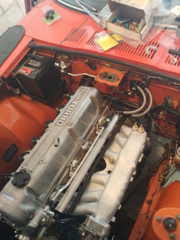

I have purchased a complete L28 turbo motor setup at a very very good price! Here are the engine specs:
L28 N42 Block with dished pistons, P90 Head, N47 intake, turbo manifold, Pallnet fuel rail + Fuel pressure gauge, 440cc supra injectors, rebuilt chinese housing turbo with turbonetics internals, turbo dizzy, and assembled with ARP studs. Came with some other misc parts as well.
