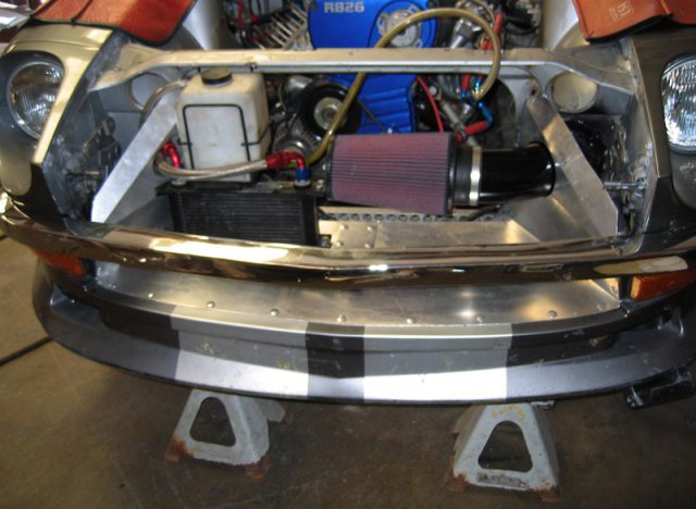

tube80z Posted May 2, 2007 Share Posted May 2, 2007 jmortensen said: I think we can. Limiting the amount of air getting into the engine compartment is a huge part of getting this done. The gaping maw in the front of a Z is way too big and allow a ton of air to get under the car, hence Z's with fiberglass hoods look like they're going to pop right off of the car. I think once the airflow going in HAS to pass through the radiator, then it's just about utilizing some hood vents to get the air out. By the way, I got that idea from a circle track site, but you see the same type of airbox almost universally throughout the racing world. I was looking at several catalogs today as I was packing them and they had the same basic radiator duct in them. Starts off with a small rectangular hole, then angles up to where it attaches to the core support. I can't remember what one it was... coleman, tc cline, pegasus, one of those. I had a airbox like that on my car. It also helps with cooling by slowing the air going into the radiator. Another option if the rules don't allow hood vents is to open the inner fenders and vent there. Ideally you should not have the tires sticking out in the aristream and a proper flare covering this. This is how most GT cars are done. Cary Quote Link to comment Share on other sites More sharing options...

a6t8vw Posted May 2, 2007 Share Posted May 2, 2007 quote from bjhines "The Type3 airdam was initially tested by simply bolting it on. Initially there was no attempt to seal the inlet to the radiator or the sides. It performed poorly in this configuration. We were so discouraged by the initial results we almost didnt blow it again. We were surpised that adding a little bit of a shelf between the radiator crossmember and the inlet of the airdam not only improved things, It actually transformed the entire car. We blew it again with even more tape sealing off even more of the area behind the airdam and things improved again! There is not much physical difference in what we did. A simple strip of foamboard and some extra tape on the sides COMPLETELY out of view turned the airdam from a total failure into a dream come true!." I'm running the type-3 air dam on my 280 and now that i have swaped in the v8 i have cooling problems, car is running stock raidiator with dual elect fans. temps are at 190-215 degrees with a 180 degree thermostat... I completely agree that air once past the air dam hits the face of the radiator and shoots down under the car, im in the process of building cardboard ducts to mask all the areas the air is escapeing... i belive it will cool the car down alot at speed, if it doesnt work i simply need a bigger radiator!! andrew Quote Link to comment Share on other sites More sharing options...
