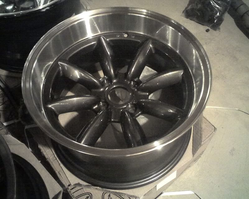

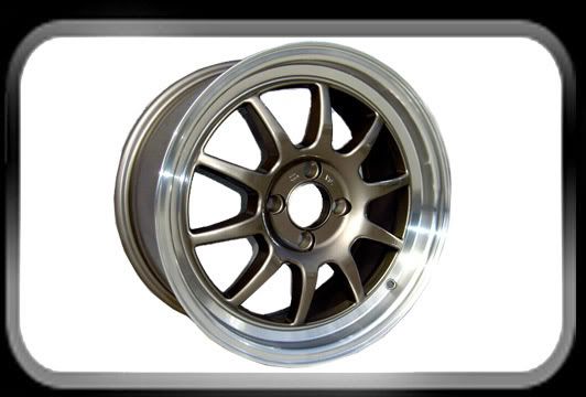

JustinOlson Posted October 14, 2008 Share Posted October 14, 2008 They look great. They are WIDE. The lip is 3" the wheels look really deep because the way the spokes curve out from the center. Great work organizing this. The bronze finish is kinda brownish silver. Its really close to this: I'll get pictures tonight when I get home. I'll bolt them on the car just to show what they look like. Justin Quote Link to comment Share on other sites More sharing options...
JustinOlson Posted October 14, 2008 Share Posted October 14, 2008 Warning Cell Phone Pictures at Night... They do clear the Yota S12+8 calipers with room to spare Quote Link to comment Share on other sites More sharing options...
rudypoochris Posted October 17, 2008 Author Share Posted October 17, 2008 Did anyone ever give the lip difference between the RB and RB-R? I thought the RB-R is supposed to have a deeper lip, and less of a build up on the back side. Did anyone ever show pics of the mock up wheels like they did on the RB model? Were there any clearance issues? I have been doing a lot of reading but not finding anything. Thanks. The lip on the front of the RB-R is around 2.5" and is 3" on the rear. The RB is 3" all around. There is no build up of material on the back of the RB-R mounting face, the dish is consumed by the deep recession of the mounting face/spokes. The RB on the other hand has a significant amount of material on the back of its mounting surface. So, in reality, the RB has a deeper lip than the RB-R on the front. It looks 'correct' though, compared to the RB in my opinion. The RB looks more like it was meant for a FWD car (positive offset). That being said, they both look great in my opinion and I would be happy with either. The mock up wheels were put on Gollum's car back in post #830, check it out! I do not believe there were any clearance issues, but some people have had issues with rubbing on the way to full lock between the front of the fender and the tire. I have not been able to replicate this issue or even get really near to it at all, so I cannot comment on how/why/what is happening. Maybe someone who has this issue can chime in? There is no difference between the RB and the RB-R though when it comes to width, diameter, offset, etc. Thus the RB fits just as well as the RB-R and visa verse. Hope that helps! Quote Link to comment Share on other sites More sharing options...

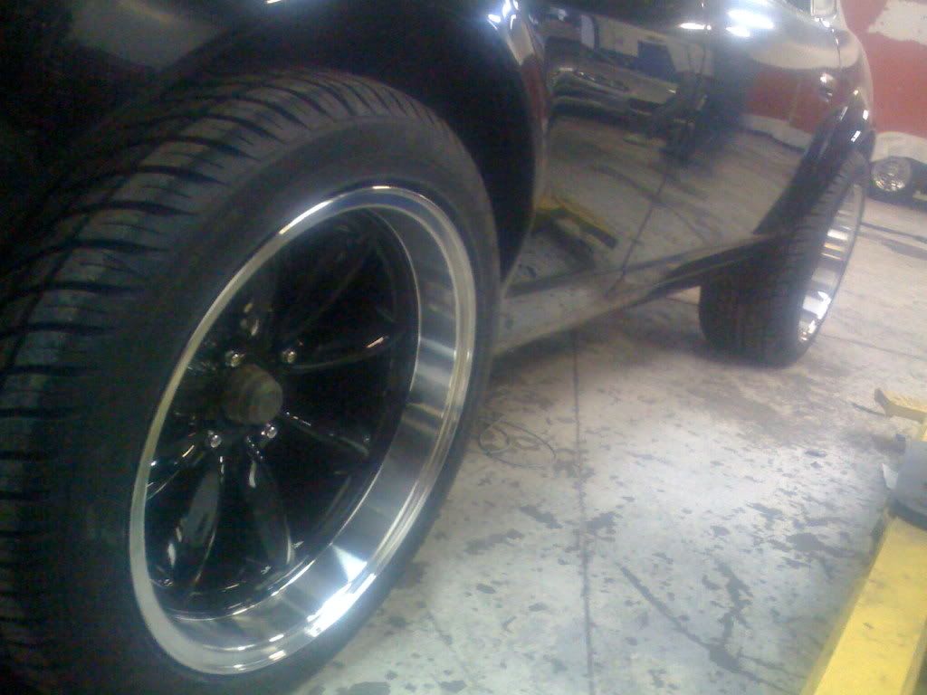

Tanman280z Posted October 24, 2008 Share Posted October 24, 2008 Thanks for the replies. I mounted the wheels on the car as it is totally suspended and it does not rub while in the air. I figured once the weight of the car is on them. It will be okay. The shop was concerened when looking at it about the clearance. The wheels are amazing by the way. I will get rubber mounted in the morning and fit them on the car again to check the turning. I will let you know. I told the shop what everyone has said on here, and they trust you sence you have all done it and been happy. Thanks again. I will figure out how to post pics so you all can see. Quote Link to comment Share on other sites More sharing options...
rudypoochris Posted October 24, 2008 Author Share Posted October 24, 2008 Well, your strut to rim clearance does not change when loaded. The only thing that could/would possibly change would be the tire to fender/air dam clearance. Post photos when you get them all done! Additionally, what are you running flare and air dam wise? Quote Link to comment Share on other sites More sharing options...

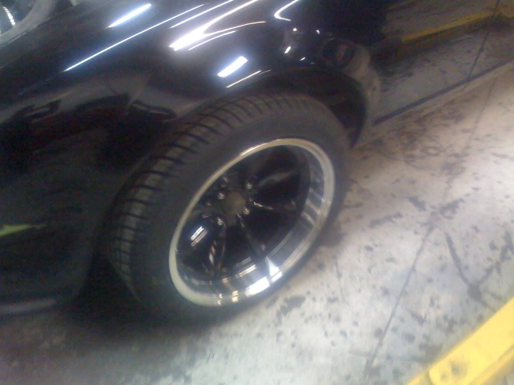

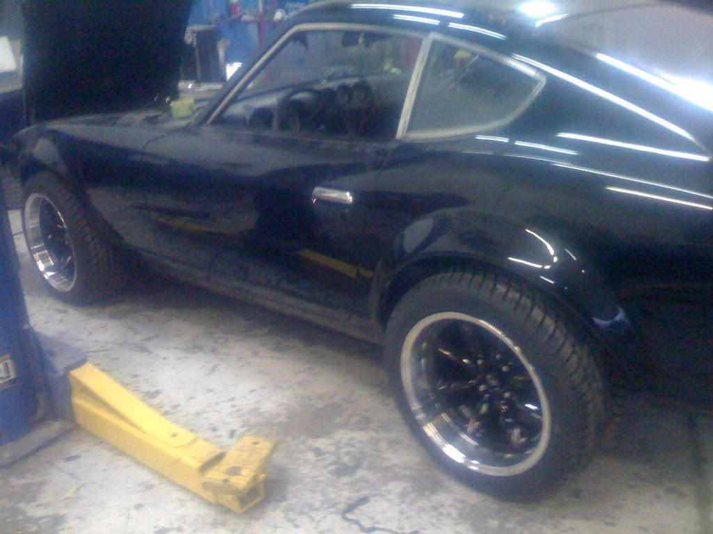

Tanman280z Posted October 26, 2008 Share Posted October 26, 2008 Okay...I cant figure out how to post pictures. But I just got the wheels mounted with ruber and wheels put on the car. I went with 9.5s on the rear and 9s on the front. I have flares, nit sure exectly what kind. This stagger is perfect. However on the front. When I turn the wheels completly, I can barely fit a pencil in betweeen the air damn and the tire. This will make it scary when turning over bumps. Straight on, I have plenty of clearance. I will get the tires posted when I get the pics on. Let me know if there is anything else you need to know. Quote Link to comment Share on other sites More sharing options...

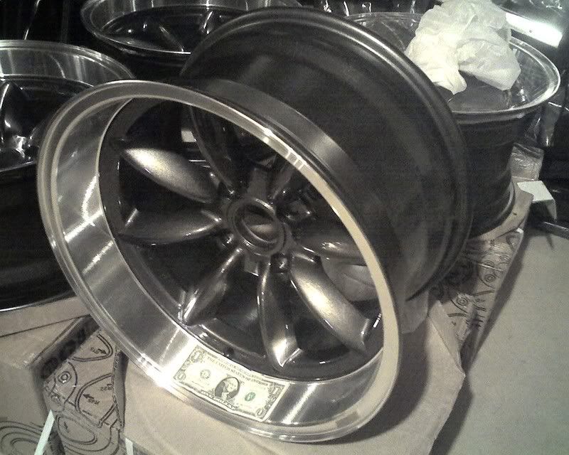

junglist Posted November 5, 2008 Share Posted November 5, 2008 Here are a few crappy camera phone pics of the RGM RB-R's that member RB240Z and I got: Quote Link to comment Share on other sites More sharing options...
