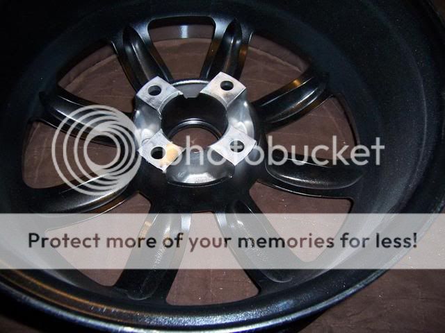

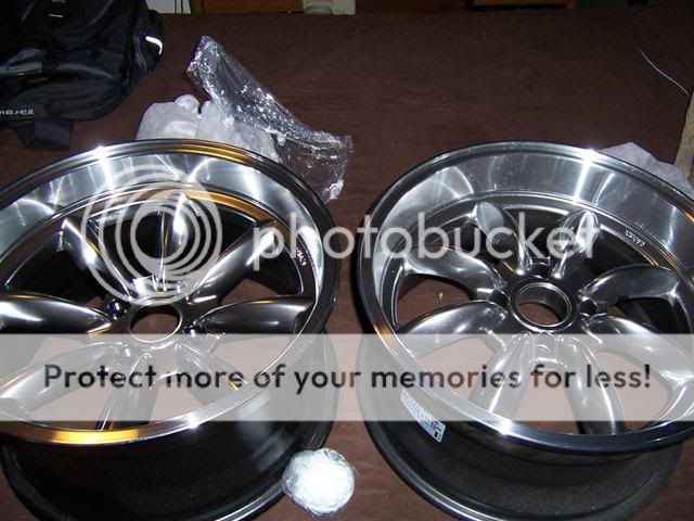

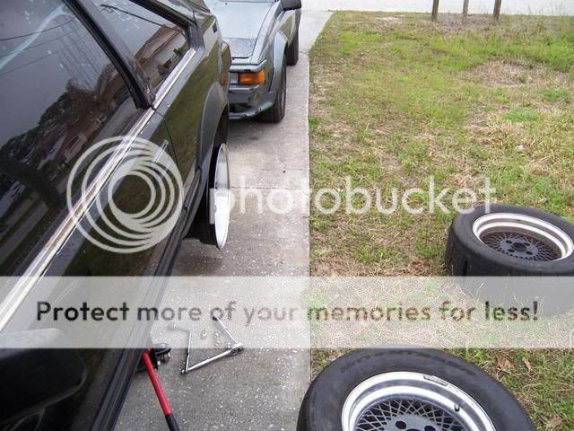

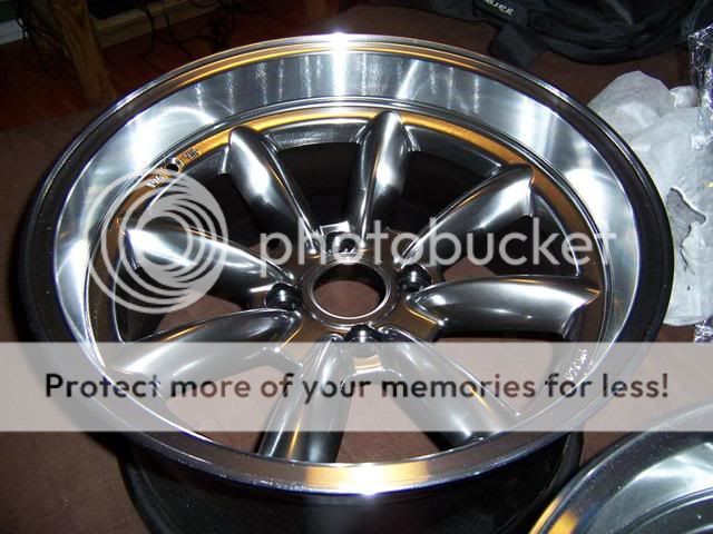

williamb82 Posted April 12, 2010 Share Posted April 12, 2010 figured id post pics of my wheels. comparisons of 17x7.5 +4, 17x8.5 =4 and 17x9 -13. i started out with 17x8.5 +4 front and 17x9 -13 rear. problem is the 17x9's have way less lip then the 17x8.5's, so would look wierd on the car with more lip up front. plus with the -13 offset, if i run a 275/40/17 drag radial as i plan, itll rub badly. so i sent the 17x9's back and got 2 17x7.5 +4 for the front instead, and moved the 17x 8.5's to the rear. they are hyper black centers with polished lip. 17x9 -13 left, 17x8.5 +4 right this is the 17x8.5 on the rear this is 17x7.5 +4 left and 17x8.5 +4 right 17x7.5 +4 17x8.5 +4 ill try to post pics once i have tires and moutn them on the car. the 17x7.5 has tons of clearance for calipers for a bbk due to the thicker pad on the mounting surface. Quote Link to comment Share on other sites More sharing options...
rudypoochris Posted April 12, 2010 Author Share Posted April 12, 2010 (edited) That is kind of apples to oranges considering you are comparing a 17x9 -13 RB-R to a 17x8.5 +4 RB. They are not the same style of wheel, hence why they don't look good together. They simply aren't the same design. The 17x8.5" RB might be called an RB-R if they don't make both styles, but the center style on that wheel is the RB style not the RB-R style. It is a bit confusing, but the 17x9 you can see the center is more sunken in and does not have the curved spokes of the 17x8.5". That center is the RB-R center, the RB center curves outward affording more lip, but resulting in a different look/feeling. You would want a 17x9" RB and a 17x8.5" RB or a 17x9" RB-R and a 17x8.5" RB-R. In any case, looks good, enjoy! Edited April 12, 2010 by rudypoochris Quote Link to comment Share on other sites More sharing options...
williamb82 Posted April 12, 2010 Share Posted April 12, 2010 thing is they no longer make the 17x9 in the rb style. only the rb-r. figured id post the pics cause some people dont want to add flares or roll/pull the fenders on their z. so the 17x7.5/17x8.5 combo would work well. Quote Link to comment Share on other sites More sharing options...
