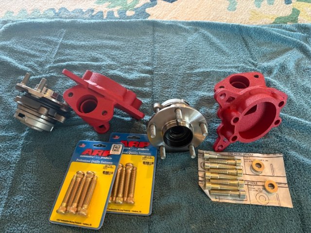

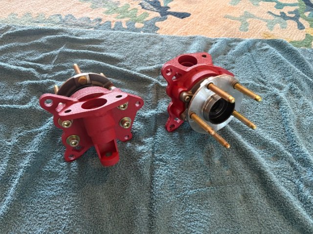

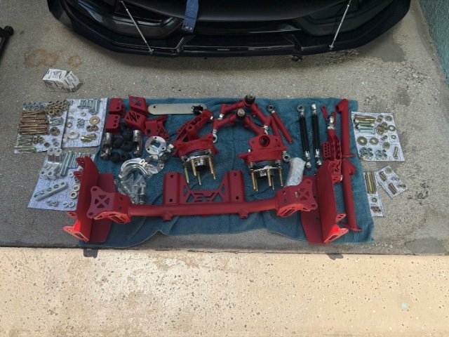

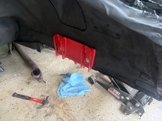

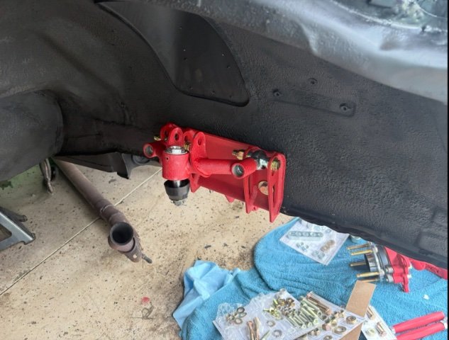

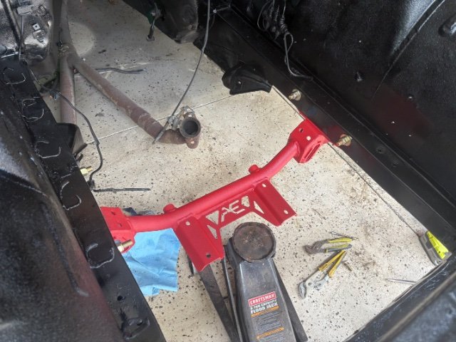

Heat advisory today, and I believe it, damn it’s hot. Started off replacing studs with APR extended studs then attaching 370Z wheel bearings to the custom spindle, did all that in the AC. Then to the outside, unboxed all the front suspension and got subframe, new plate for control arms and upper control arms up. Stupid plate was near impossible to install. It’s perfectly shaped to frame, bolt holes don’t align when carriage bolts are up, and plate doesn’t align and fit on when carriage bolts are down. Took forever halfway adjusting it, having my dad tap carriage bolts from top while I’m holding and aligning from bottom. Nightmare, but finally got it on. Hopefully the rest will go smoother. Did I mention I’m exhausted -
