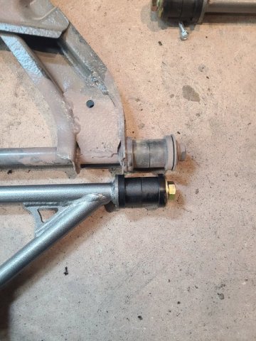

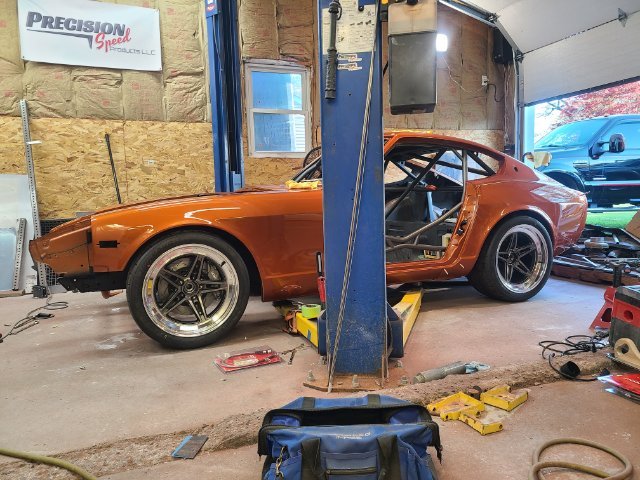

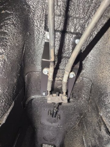

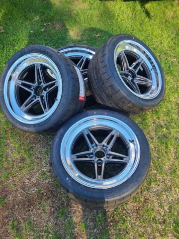

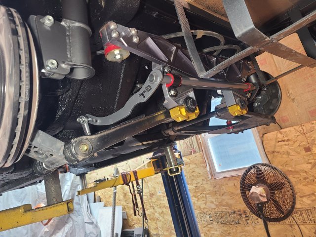

APEX said they would have a set made up by friday but haven't heard from them. Added a photo showing the APEX control arm length issue. Other bushing is lined up and its about 1/2" short. Put the rest of the rear together so i could sit it on the ground with the wheels and tires. T3 r200 short nose kit and rear sway bar. Got my tires in so got them mounted and installed for some motivation. Since I am using 300zx rear drum ebrake. I decided to use a 240sx ebrake handle (since I have this combo in my 240sx). Modified the handle to fit in the stock Z location. Mounted the cable holder thru the floor. Made a couple small brackets to hold the cables in the correct spot. Adjusted and works great. Also added a couple photos of the brake setup. - Yesterday

I heard back from APEX and they are making and sending me a new set of arms that is correct. Not sure what happened but mistakes happen. Not ideal for timeline since I need to roll the car out of the shop next week so I'll have MacGyver the stock arms back on with mismatched hardware to make it a roller for now.
