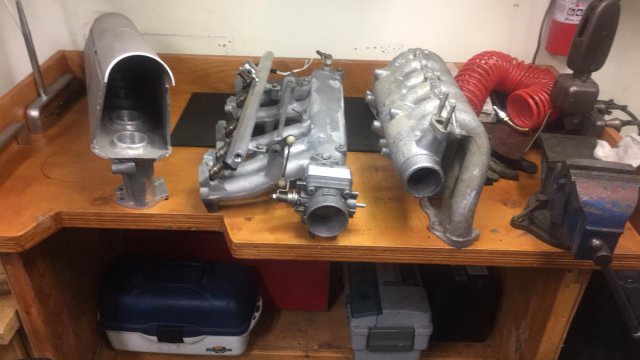

  6. madkaw

  15. You mean like the one on the left in this pic ? Canon manifold
