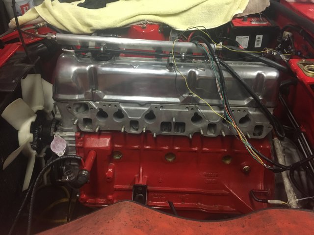

So your saying Matt that my plan is okay to run these IAC wires along side the sensor wires ? I have taken great measure to not have noise issues and so far I have had NO issues with my MS 3 and enjoying EFI life . Very happy to see my plugs looking like this with my 490/290 cam . Engine idles at 800 and has the same power as my triples !

A lot of early Z’s had holes under the battery tray for A/C , that’s what I used . I also used the choke cable hole . I used the choke hole for sensor wiring ONLY . I fed all power and grounds under the battery. With MS there was two harnesses and almost 80 wires I think , but you don’t use all of them - more than likely - so I condensed inside the car and fed only necessary wires thru the firewall.

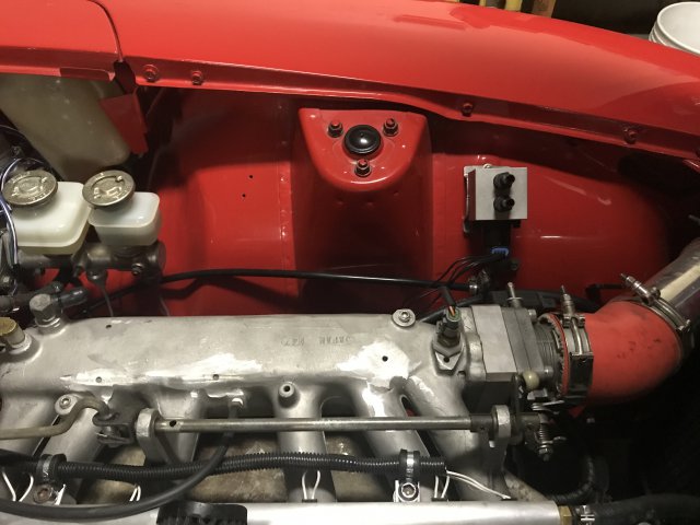

Well the trigger wire on the MS3x harness was already shielded . The problem is that I DO WANT to run my IAC wires parallel for packaging reasons . I might be able to minimize this , but the most direct route is with my sensor bundle .Theres a local electronics store down the street ( lucky me), so I might see if they have some shielding

Well on to IAC . Car is running fantastic but it's starting to turn cold and start ups might need a little assist. I am going with the 4 wire IAC from the Jeep 4.0 DIY Tune makes a block for mounting the IAC valve . New Borg Warner selonoid is about 45$ and pigtail is 18$ at your local Oreillys . So far - besides pulling wires- the hardest part was figuring out a mounting bracket and a place to mount . Didn't want to drill holes and it has to somewhere to make running vacuum lines handy . Plus this hunk of aluminum is big! Right now my question that bugs me is whether running these wires close to my sensor wiring is going to cause noise. It sure would be handy to run the wires there, but so far noise has not been an issue and I want it to stay that way.
