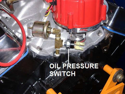

The previous owner (PO) made a mess of the fan and, possibly, the fuel pump wiring. The wiring on my first 240Z V8 project car was so messed up by the PO that I had to completely redo the engine bay and fuel pump wiring. There was no other choice but to gut the getto wiring and start over. Recommendations: 1. Buy the Jags That Run book "Datsun Z V8 Conversion Manual" here: http://www.jagsthatr...tsun_Z_V-8.html The manual explains how to do a 240Z V8 conversion. Among many conversion topics, the JTR manual explains how to safely wire the fuel pump through an oil pressure fuel pump safety switch. Run the output from the oil pressure safety switch to the trigger contact on a Painless Fuel Pump relay kit. The kit comes with correctly sized wires and instructions. Note that the 240Z has an unused fuel pump wire (green) that you can attach the relay output to. Search HybridZ for the green fuel pump wire. Read the JTR manual at least five times. It covers about 90% of what you need to know to own a V8 Z car. Do not run your fuel pump through a switch without using an oil pressure fuel cut-off switch. Without the fuel cut-off switch imagine yourself pinned in the car and the fuel pump is still running and dumping fuel on the ground. 2. Obtain electrical schematics for your Z car such as a Haynes Manual, Factory Service manual on-line download etc. Search HybridZ and/or Google for schematics. 3. If electrical wiring is not your strong point, have someone with automotive electrical experience check out the car's wiring. You want a reliable and safe car when you are done. 4. Be sure that the fan and fuel pump are on separate fused circuits. 5. Electric fans draw high amps. Do you have the best fan and radiator combination for your application? Again, see the JTR manual. I use the JTR radiator and Flex-a Lite FXL-180 fan (built-in thermostat control) Attached is a picture of an oil pressure fuel cut-off switch. Does your car have one? -
