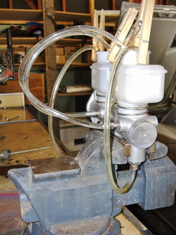

Master Cylinder Bench Bleeding
Miles replied to m1ghtymaxXx's topic in Brakes, Wheels, Suspension and Chassis
I use speed bleeders with teflon thread tape. For the flare nuts that attach to the outlets I just wrap the flare nuts with the teflon tape. Also, make sure that the flares on the old brake pipes you use for the outlets are in good shape or they will suck air. I learned all of this while bench bleeding a new master cylinder that kept producing bubbles. At first I blamed the speed bleeders until I checked the old flare fittings at the outlets. To fix the problem I went to Pep Boys and bought a new 12 inch brake lines with the correct flare and threads and then cut out two four inch pieces using a tubing cutter. I then formed a 90 deg. bend ( to clear the vise/bench) in each tube using a tube bending tool. No more air leaks through the outlets while bench bleeding. -
See picture for bench bleeding set up. I open up both bleed nipples and then push the piston in slowly until all of the bubbles are gone. When you remove the fittings in the outlets fluid will leak out so I plug the outlets with small rubber stoppers. Remove the rubber stoppers just as you are hooking up the hard lines to the MC to minimize fluid loss. Also, I hook up the hard lines before I bolt the MC to the booster. Makes it easier to line up the hard line with the MC outlets. The fittings in the outlets are old brake lines. Be sure when you attach the fittings to the MC that they are tight or air will be sucked in as you push and release the piston. Do not clamp the barrel (cylinder) of the MC in the vise as you could deform the cylinder causing it to leak.
