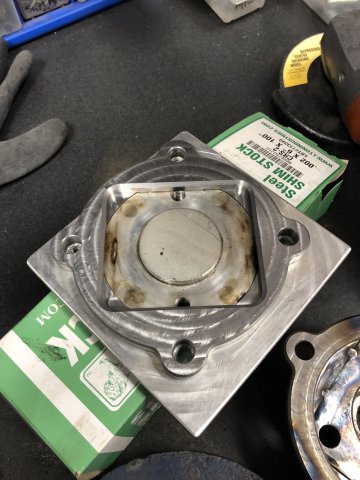

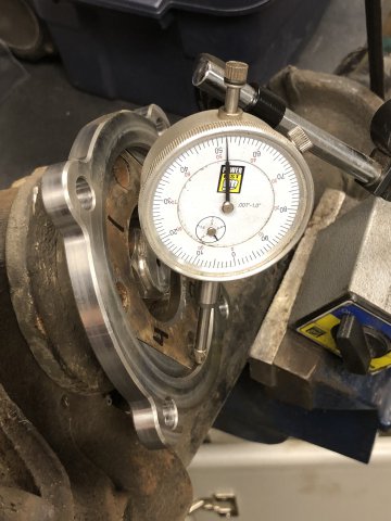

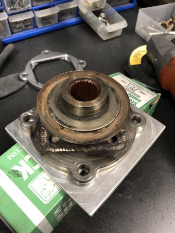

Great questions. We found out the hard way that the square flange isn’t concentric. It’s a rough cast and can be off almost 1mm. The z31t axle centers on the locating ring of the adapter. The adapter sits flat to the machined face of the stock flange. That takes care of 2 orientations. To weld the adapter on correctly we made the square a touch small. That way you can strategically grind the edges of your square flange to be equal from the Center locating ring. We recommend using a dial indicator to verify you get it reasonably close. If it’s a little big, you can use feeler gauges, shim stock, or even paper as stock to shim it true before tacking. Or you can rent the jig we made to locate it. Haha both options shown in pics

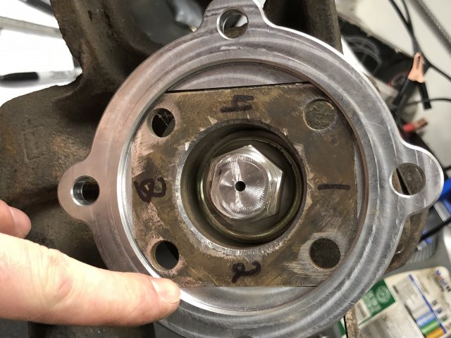

Here’s what our slim welded adapter looks like. Basically converts the stock flange to a larger one. Stock z31t axles fit like this. 4 fasteners a side = winning.
