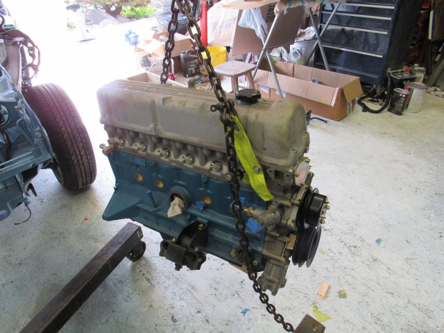

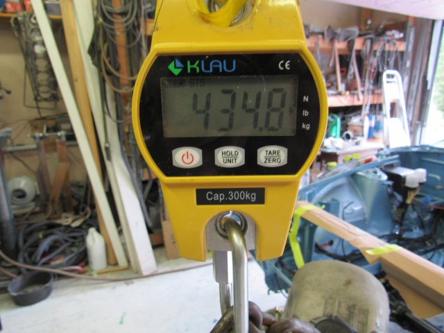

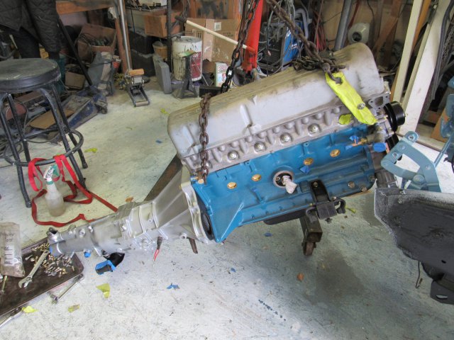

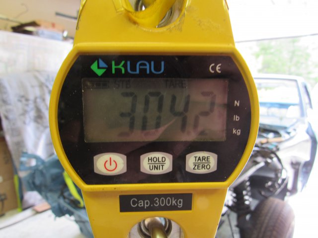

Here we go, the crane scale is accurate, the engine leveler is 10lbs so subtract that from the totals. S54 with partial headers, throttle bodies, damper and some coolant pipes. No stater or Alt. 341lbs With flywheel and clutch pack, 380lbs 6MT transmission , 105lbs. Total 485lbs. L28 and flywheel/clutch pack plus 5spd transmission 425lbs. -

I read on one of those spec lists the S54 weighs 328lbs but it didn't say what that included. This L28 weighed 304lbs but it only had the cast iron exhaust manifold on it. I'll see if I can get a weight on the s54 this weekend. -

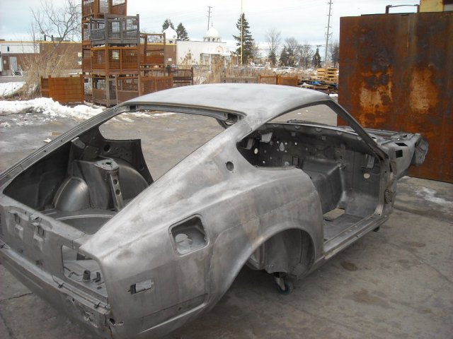

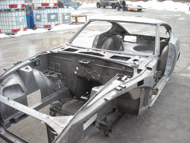

I had my 72 dipped a few years back, you are working against time now that the metal is unprotected, the place that did mine sprayed the shell down with a water based rust inhibitor that was good for about 10 days. Something like this for inside the subframe, https://www.eastwood.com/eastwood-internal-frame-coating-14oz-aerosol.html Personally, I cut out those pitted ares and weld in new metal, but somewhere like the spare tire well I would just seal it well. Before you spray the epoxy make sure the metal is really clean, I use a lye based cleaner like Purple Power, then Methyl Hydrate, then wax and grease remover.
