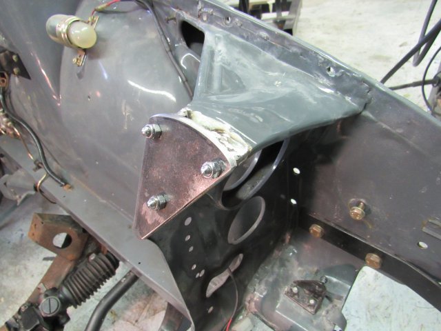

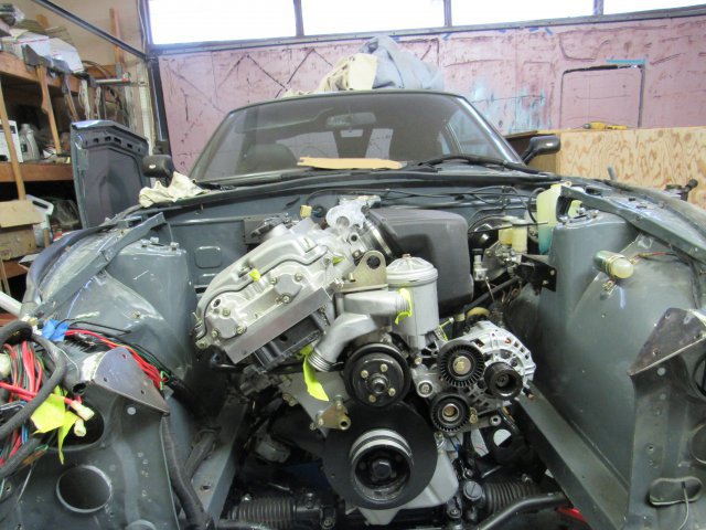

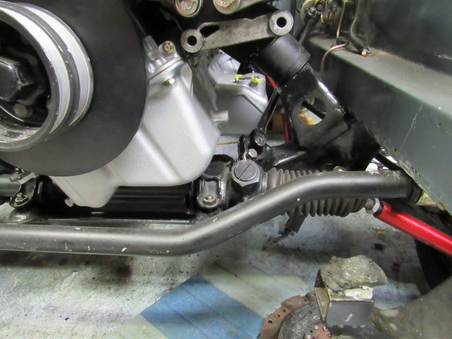

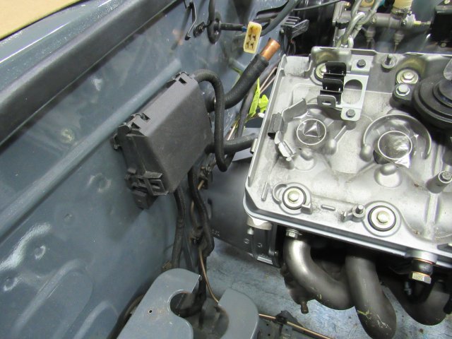

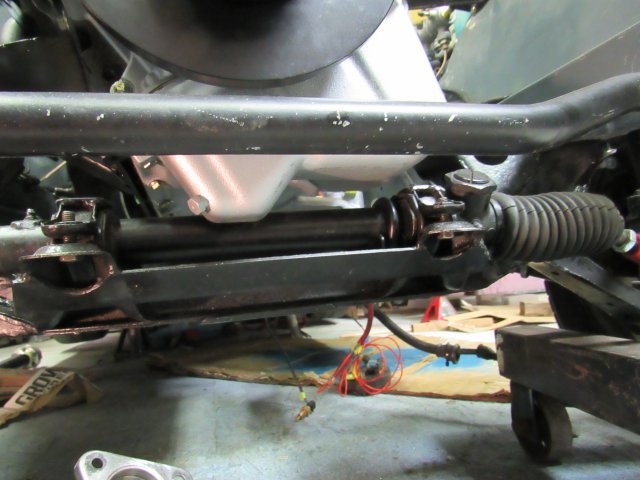

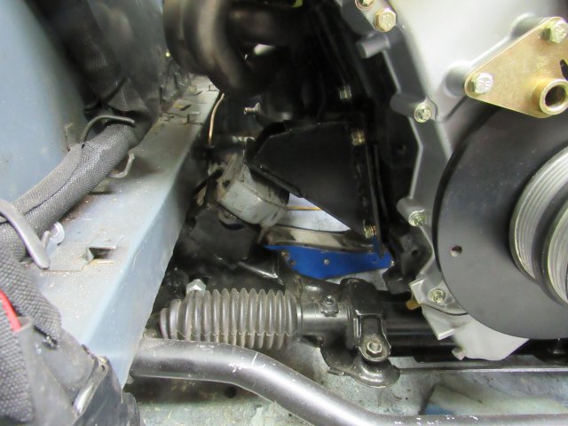

	Okay so I'm dragging this one back out because big changes are happening, the S38 engine experiment was a success in many ways and in a few ways not so much. So I pulled it and sold it on BaT, wonderful engine but it is just not supported anymore. I have rebuilt the e46 S54 M3 engine and that will be the new power plant. So far the swap is going well, the engine is in, transmission and diff are lined up and the custom driveshaft is being built right now. I should have it back in a week, next step is to have the BMW ECU re programed to eliminate all the extras that aren't needed and set to wiring it up. I finally got around to making the top of the radiator support removable, considering how often the engines come and go it will be a big help, just have smooth it out, do some filling/sanding and try to match the paint. The original intake airbox sticks right out into the shock tower and also had problems with the #1 and #6 cylinders having uneven access to air so I have opened it up will try to fabricate a custom funnel to the air filter. @carbuilder723, was nice enough to sent me the drawings for Ron Tyler's BMW engine mounts and after making cardboard mock ups of them I could see they just weren't going to work for my swap, not sure why. So I made a couple of rough mounts and once the bulk of the work is completed on the swap I will take them off and clean up the welds and finish them a bit more.
