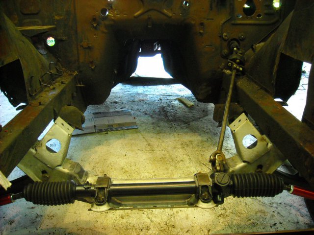

Have got a bunch of stuff done since my last post, installed the TTT offset tierods to compensate for the the lowered steering rack, Built the engine and transmission mounts and modified the crossmember, So here is the room left to play with, about a 1/2" between the top of the engine and the hood and about the same with the oil pan and Xmember, Built a skid plate to protect the oil pan, Lower radiator mounts are finished, and have finished installing the electric power steering,

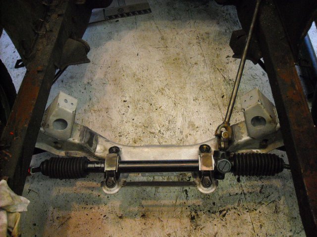

I had to lower my steering rack to fit in the engine that I'm installing, without these- my bump steer was crazy, with the off set tie rods from TTT I have the bumpsteer down to couple of mm from normal driving height to fully bottomed out. Mine is an extreme case but all you are trying to do with the off set tie rods is make sure your lower control arms are parallel to the tie rods. And yes you do have to drill out the steering knuckle with the drill that comes with the tie rods. Not parallel, Parallel -

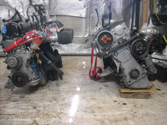

I have finally got to the fun part of the build, just about to start making decisions on the placement of the engine/transmission. The engine is a 3.5L slanted straight six. Does it matter if the weight of the engine is taken by the crossmember or the frame rail? Will it change the center of gravity? I'm just trying to keep my options open and would appreciate any input. Thanks, Chris The engine on the right is the new one.
