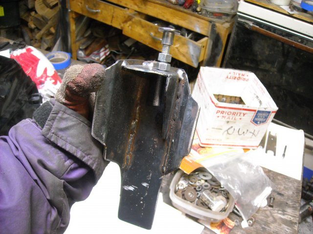

That is why you pre load the brace against to M/C with the threaded rod so there is no movement to begin with, the shock tower, M/C and firewall sort of become one so when you push the brake pedal that force is spread out to the front suspension structure and the firewall resulting in less movement and hopefully a better brake pedal. Once that cap is tightened against the M/C there should be no movement between them. -

HaHa, that's good one, that will never happen if it is left up to me. Flats on the cap? Oh I get it, the cap touching the end of the M/C spins freely, the flats are on the threaded rod right next to the cap for pre-load adjustment and the nut is for locking it in place. -
In my on going efforts to build the perfect Z (for me) I thought I would have a go at firewall flex or that brake pedal that never really feels solid. Nothing new here just copying the principal of supporting the master cylinder - brake booster - firewall - brake pedal box. Hope this is of use to others.
