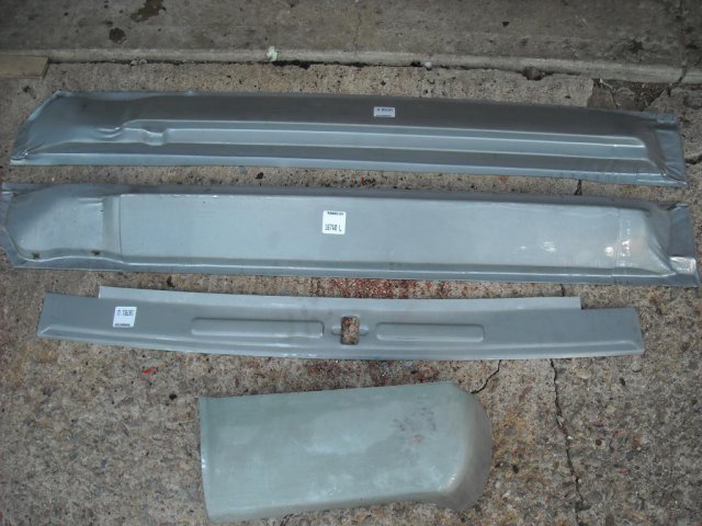

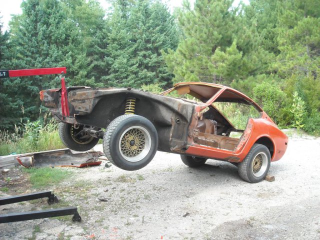

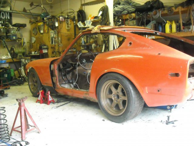

Spent the last month cursing Megasquirt but finally got the engine to idle yesterday so there is hope yet. Got he Z into the garage and started digging for rust, didn't have to look too hard. Found some 1st class repair work along with some previous occupants. Picked up some new wheels and some repair panels from Tabco.

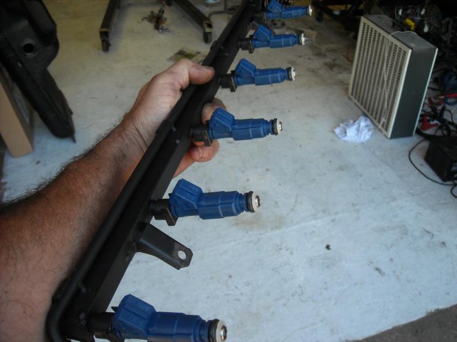

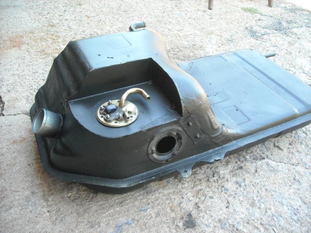

Look what came in the mail, Here is the finished tank ready for install, Now that I'm changing the ECU I took the opportunity to change over to high impedance injectors and bumped up the flow from stock 24lb to 30lb, that will give me a bit more room to push up the power output.

Just a thanks to all of you who posted pics of their tanks, I was having a hard time picturing how to do this before finding this thread. Here is how mine turned out,

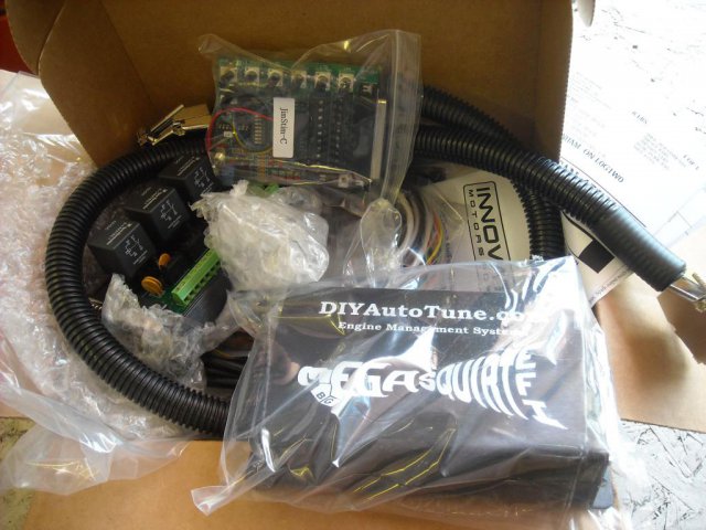

I have tossed the entire Motronic ECU in the trash, farting around with an old unsupported ECU is just a waste of time. Have just ordered all of the MegaSquirt stuff from DIYAutoTune.com Here is the list, I'm happy to listen to any tips or tricks from you MS guys. MS2357-C MegaSquirt-II PCB v3.57 (SMT) Engine Management System w/ black case Jumper for VR input. MOD_2357IGN1 Modify Megasquirt-II V3.57 for single Bosch BIP373 ignition output on pin 36. Uses JS10 for spark A output pin. Spark output needs to be set to Going High. JimStim-C JimStim v1.5 Assembled Unit 'JimStim' Stimulator with Wheel Simulator version 1.5 MSRelay-C MegaSquirt Relay and Power Board - Complete Assembled Unit MSRelayCable 4' MegaSquirt Relay Cable 1 85.00 85.00T LG-WireBund 10 foot (3.0 meter) bundle of prelabled TXL automotive wire. IATwPiggy GM Open Element IAT sensor with 6' pigtail 38NPT-Bung_A 3/8' NPT Aluminum Bung, with galvanized steel plug. Perfect for welding onto intake/coolant plumbing for IAT/CLT sensors. TuneCable6 6' Ft DB9 Male / Female STRAIGHT THRU WB-O2BP Mild Steel 18x1.5 thread- chamfered both sides.

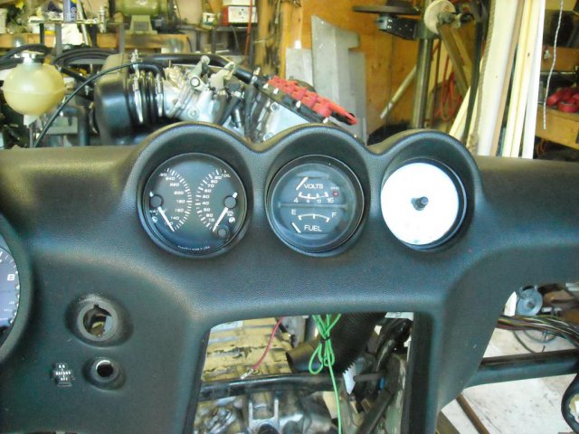

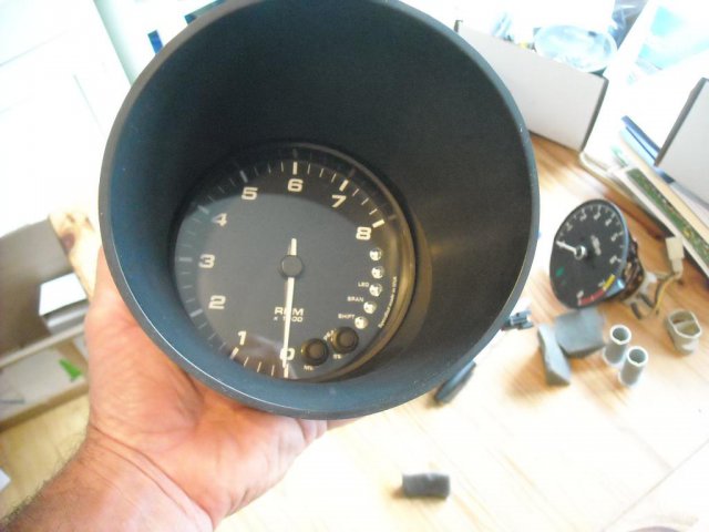

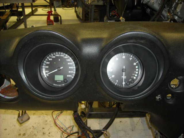

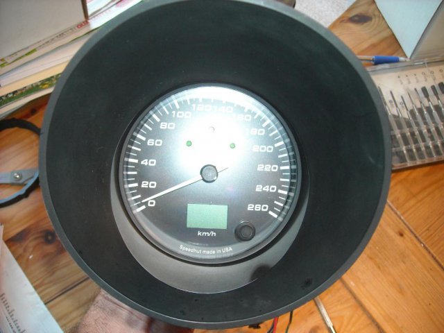

Man I wish I had known about this group buy, I just paid full price for my speedhut gauges. I used the hollowed out stock gauge for the new gauges, they fit in perfectly. The smaller gauge worked okay but not as well as the tach and speedo.
