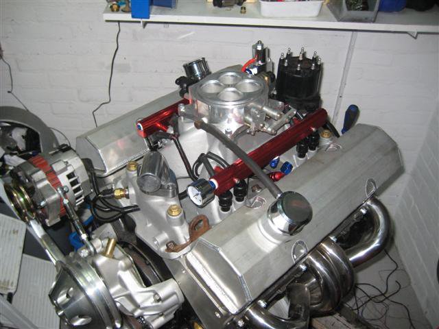

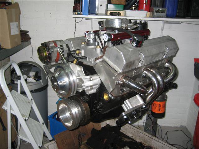

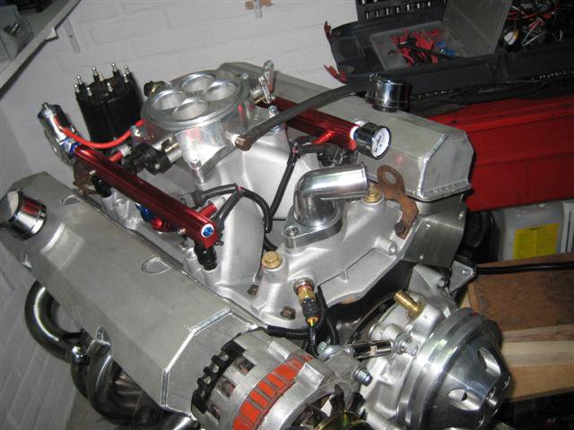

this is what I am building right now. It's a 305 out of a '92 van. It had throttlebody injection. Now it has a super hurricane efi manifold and fuelrail made by professional products. the manifold and rail are less than $300. The throttlebody I got of Ebay. You could also use a modified 4 barrel carb to use as a throttlebody.
yeah, I read that too. But I did not have a set of heads and the price was right. Plus I don't mind being the guinea pig. And as I said they did look good to me. no burs or casting flaws. come to think of it, my E88 cylinder head had some burs too. Right at the sparkplug hole. I am building this engine cheap. The intake is a professional products huricane EFI manifold and the SS headers are straight from Ebay. we'll see.
I bought a set a couple of months ago for my 305 build. I have no experience with sbc heads but they look OK. I hope to start the engine somewhere in february. I will let you know how it runs. here are som pics:
