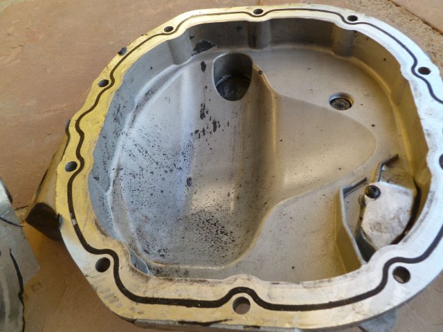

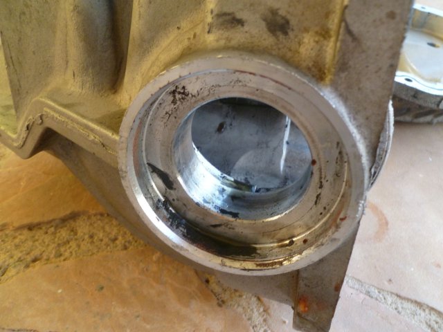

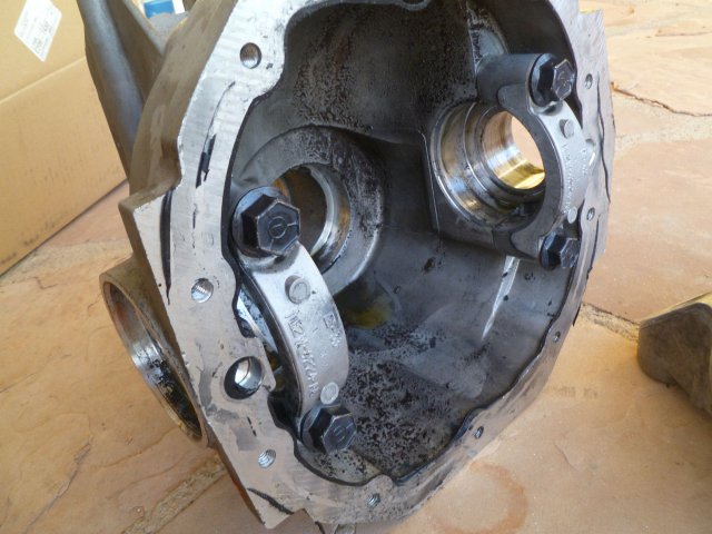

Went up to visit the car today and pay off some of the bill and generally view the progress. The engine bay is almost complete, just need to remove and back fill the rivnut holes that were intended for the battery tray that will no longer be used. Prior to this round of work, I had Tho weld in rivnuts to make the cleaned up battery tray removable, but after committing to the fuel cell I will mount the battery in the back as well. A few of the factory spot welded areas will be beefed up with new spot welds beside them also. Opened up the Ford 8.8 irs diff to find a watery mix in with the synthetic fluid which has a grit like, dirt texture inside. Starting to wonder if this diff was involved in a flooding. Not quite jiving with the sellers story ,but I was in need of a housing anyway and it is very externally clean. None of the gears are damaged in any way thankfully. I will be cleaning this out this week and getting new bearings and gasket. That's about it for this past week, but stitch welding will continue starting in the cabin.

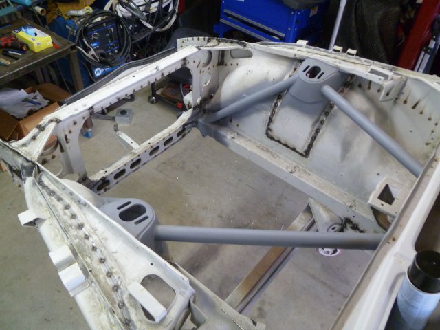

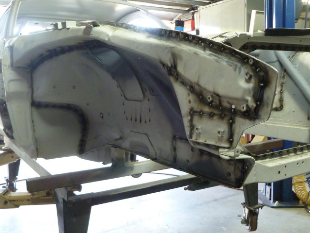

A few pics of the initial front end stitch weld progress from this past week. The Endura brand epoxy primer has been a real challenge to remove and prep for the stitch welding. I have been super stoked that it has lasted as long as it has since it was applied several years back, but it has slowed down the welding with pre prep. I am in the process of breaking down the diff to bring up to Anaheim and have it vapor blasted, but have been contemplating having it dry blasted then powder coated instead. Not quite sure which path to take just yet. More to come.

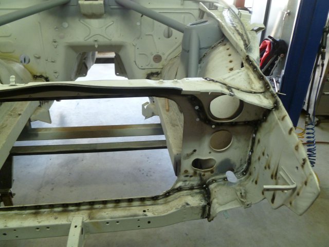

Finally got the old project moving in gear and loaded up for a little 45 mile drive up to Tho Chung's garage at Time Machine Racecraft for more stitch and spot welding as well as some fabrication. I also got a chance to see his '74 Mazda RX4 that I love in that green color. Also snapped a few pics of the front upper engine bay structure that was crumpled in the previous owners wreck. I am on the hunt for a replacement piece if anyone has a clean non rusty/crusty piece on the passenger side.I am planning on having the new Ford 8.8 lsd vapor blasted to remove the years of oxidation and leave a clean even sheen. That's it for now....
