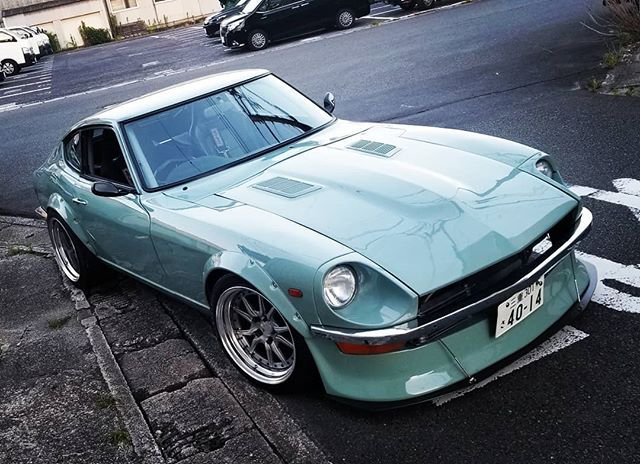

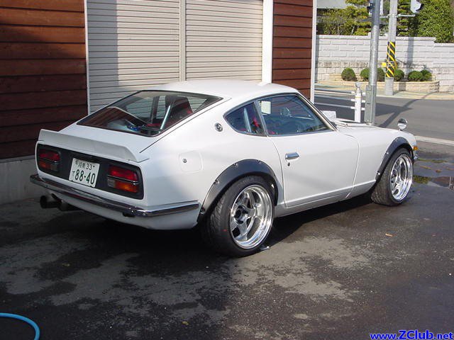

I chose to go with some Forged Volk Te37V in (17"x 9"-10 & 17 x 10" -20) and (245/40/17" & 275/40/17" BF Goodrich Sport Comp 2). Some other 17"- 5 lug wheels I had also been considering for my build consisted of SSR - Professor SP1R, Boze Forged - Shifter or Velocity, CCW - Classic mesh, Barramundi Design Forged - Payara, Bester or Jellynose. I also considered finding some 17" Work VS-XX or VS-KF and having them re-barreled to fit my needs as well as some Watanabe RS8's. As my build has been progressing and power levels rose, I bought new rear quarter panels from Ztrix.com (YZ option) that accommodate a 12" rear wheel and wider than my already applied (Subtle Z option). As much as I love my new Volk TE37 V's with the 275's I may be looking at changing the wheel selection to accommodate a rear 11- 12" and 315's to fill out the new intended flares. I just want to get as much traction to the ground as I can. A few photos I have found along the way showing the wheel styles.
Watanabe now offers a two piece 17" wheel (RS8) in both 4 and 5 lug options, but in different offsets. There are a few companies, (http://love20bee.com/), (http://wheelflip.com/) that are re- barreling these to fit whatever your needs are. Tire options and a classic banana spoke style are now an option.....
