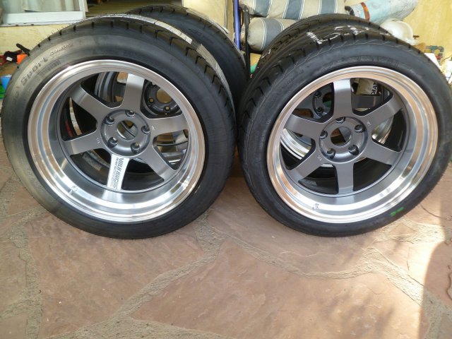

I have the front wedge shaped bumper in fiberglass from the Pandem kit that I ordered through Greddy.com. It was not the greatest constructed piece, but I contacted Greddy who also sent my supplied pics to Pandem who made good with a whole new one shipped for free. I was not expecting that nor did I push for that extreme result. The new one was of better build quality, but a little thin on the under side V/wedge area. I have to customize it to fit the rest of another front end wide body kit from Ztrix. I also have a full "Subtle Z" kit from Ztrix.com that increases width 1.5" over stock. Since having the kit blended on to the rear quarter panels, I decided to go wider rear and ordered the "YZ" quarter panels that offer 3" over stock width and allow a 12" wide rim to fit. There was some small fitment work required to get the Subtle Z kit to fit as to be expected with fiberglass and I suspect the new YZ rears will require some as well. John Washington of Ztrix is a stand up guy with very good communication and willingness to do right by you, I can't state that enough.... Here are some pics of my car project with the subtle Z kit, subtle front and rear YZ taped on for a quick visual and lastly the front bumper from the Rocket Bunny kit which will require work to fit my front. Hope some of that helps.....
Does Rota not make a 16x8 or 16x9 RKR?

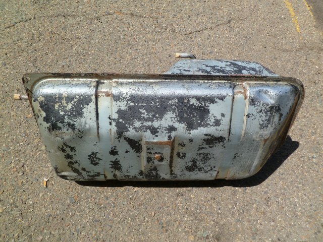

I had great results with soaking my tank with Evaporust. They now make it in a gel form to fit into tight spaces. -

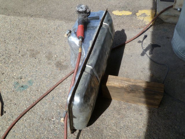

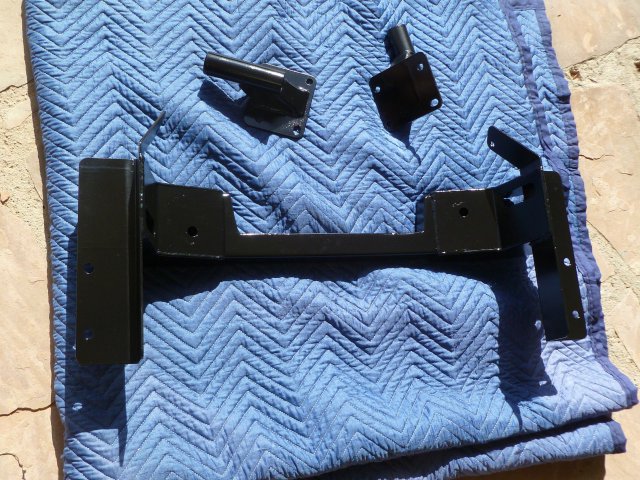

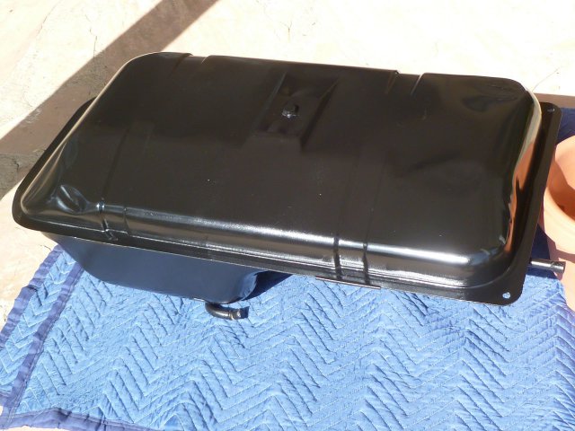

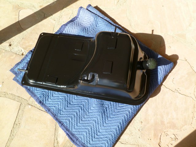

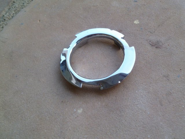

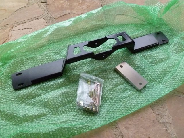

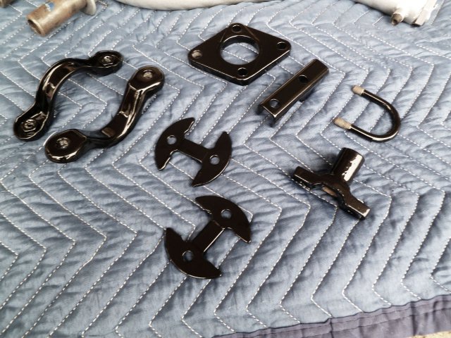

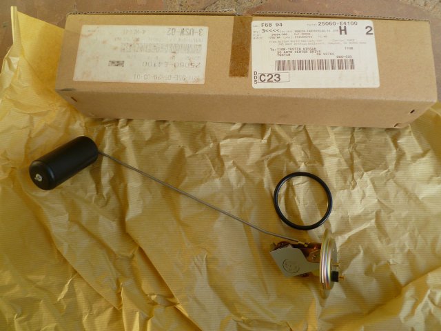

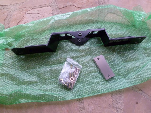

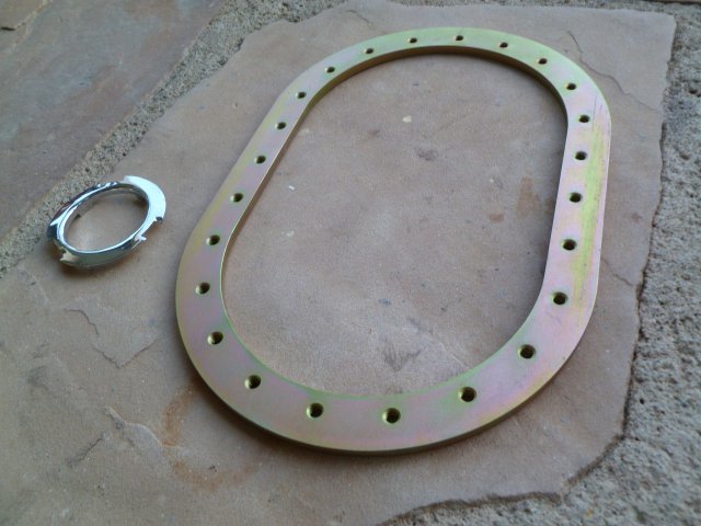

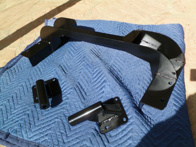

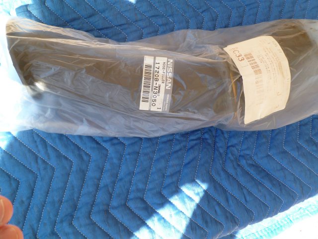

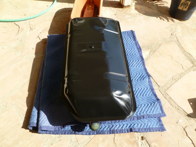

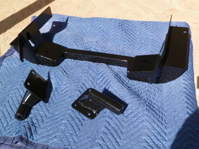

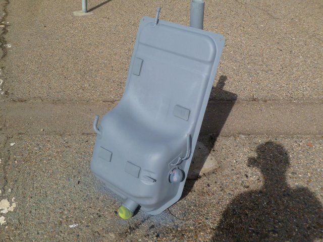

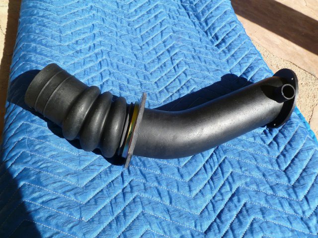

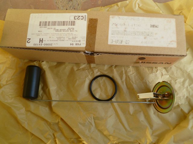

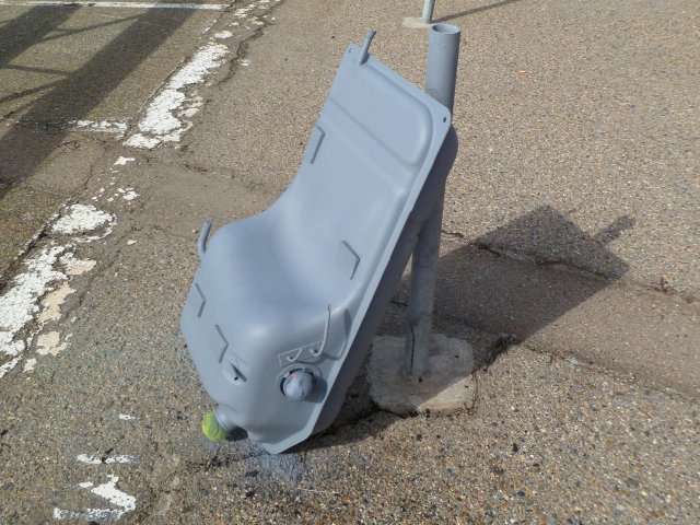

I started on a few small projects of my own as in stripping the exterior of the stock gas tank priming then painting it. I also soaked the inside with Evaporust for three weeks flipping it around in a big tub as over time in storage it began to have flash rust form inside. I originally had it hot tanked at Ace Radiators in San Diego years back with intentions to modify it into a custom fuel cell. I bought a member made ring and had it Cadmium coated as well as bought new fuel filler tube and fuel sending unit from MSA. Stripped the outside paint with Aircraft remover, my Crud thug and 3m wheel. Applied Dominion Sure seal etching primer and finished with Rustolium gloss black rattle cans. It's an amateur job at best and shows the dings and dents, but it sure was fun doing it. I also took my new used Tech 2 Motorsports 2JZGTE cross member and engine mounts and applied the same Rustolium gloss black to clean up the scrapes from the previous owner who test fitted his engine in the bay with it. I intend to sell the stock tank, filler tube and fuel sending unit soon. Lastly I wanted to have all the cross members, mounts and steering pieces in a uniform gloss black color so painfully had to take back some of the components I had powder coated in a wheel silver years ago to have re powder coated in the mentioned gloss black. I also took the front T3 lower control arms apart and along with the rear Z Race Products had them coated in a sparkle silver and the tc rods in a candy sparkle red to match the aftermarket front sway bar I had done along time ago. Lastly I came across some new, unused Bad Dog single point jack plates that I forgot I had in an improperly marked storage box. I soaked them in the Evaporust to clean them back to original condition and will put them up for sale shortly as I will not be using them. That's about it for now...

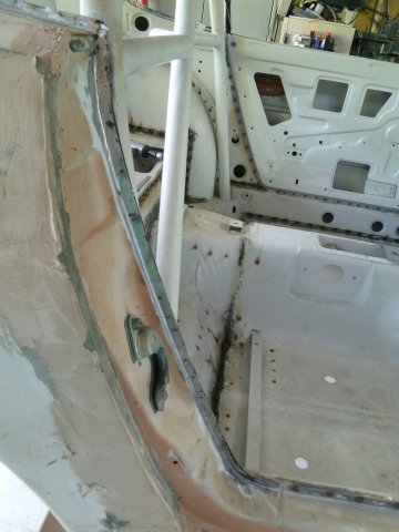

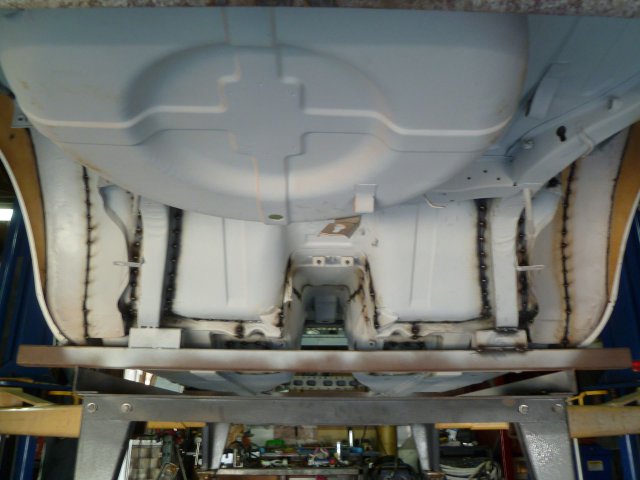

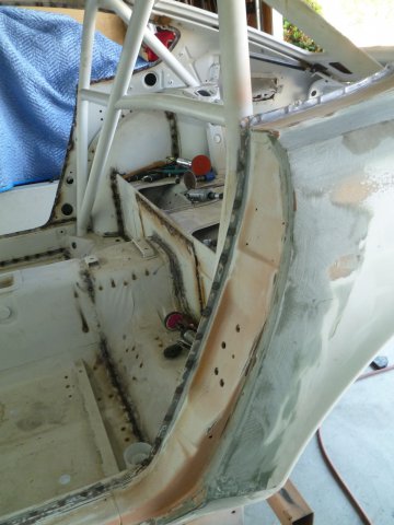

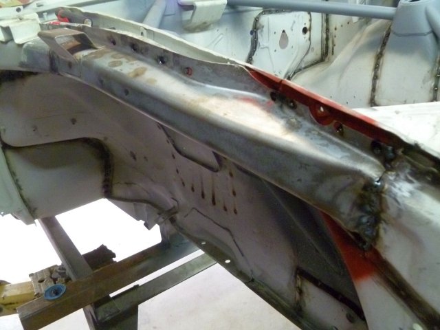

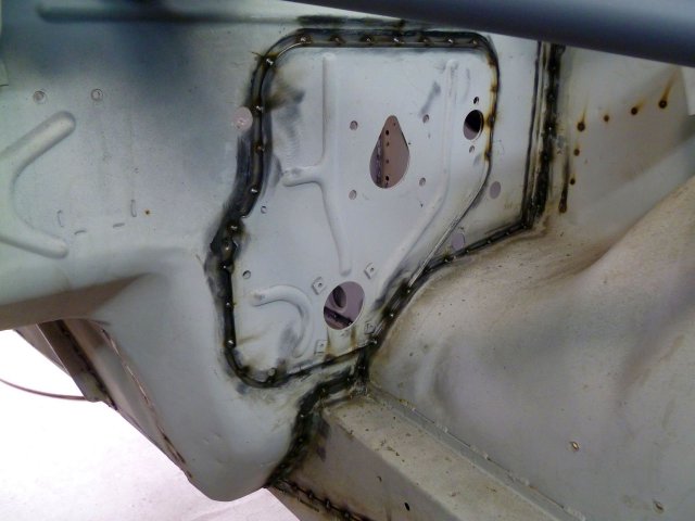

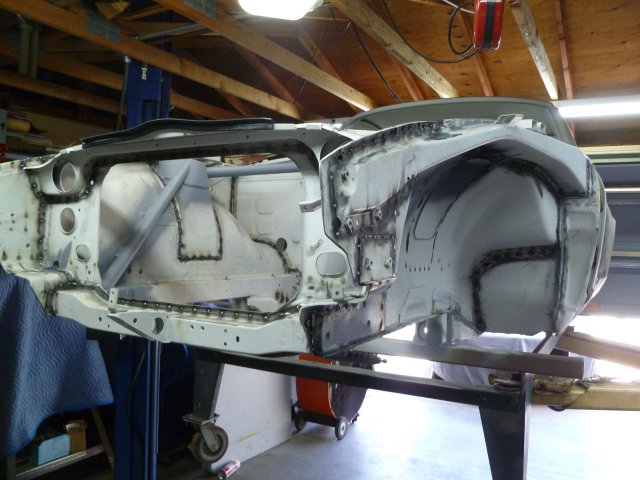

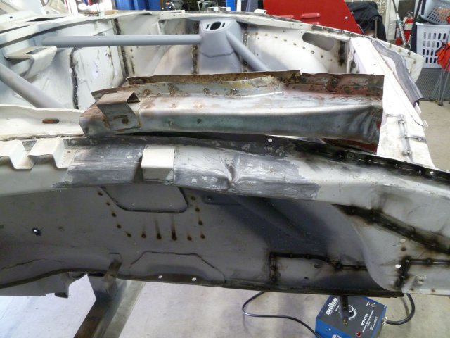

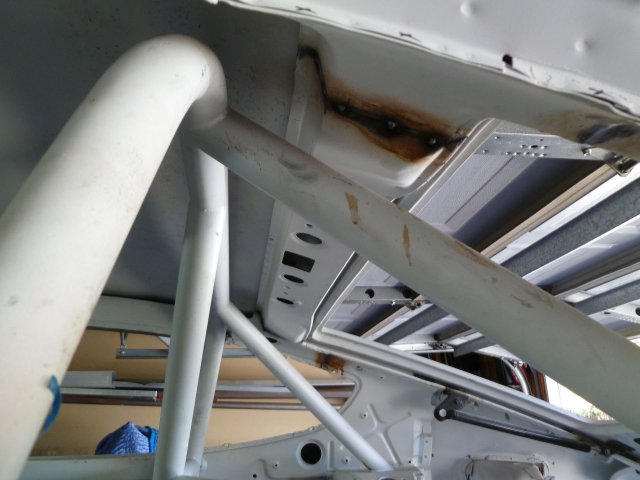

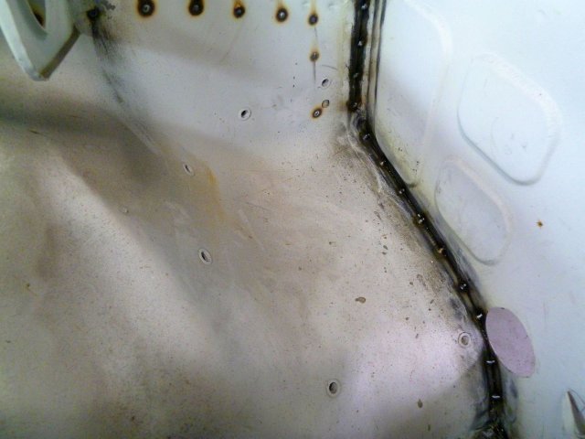

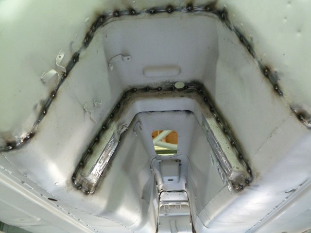

A little update on the work that has been happening for the last month plus. Almost all of the stitch welding is complete from the front of the rear shock towers forward. I will have the rear finished at another time when we get the 15 gal Radium (FCST) fuel cell surge tank and have the car back on the intended suspension and wheels. The rear spare tire will obviously be cut out and provide better access to the intended stitch welding areas. The passenger side rear quarter panel that was poorly applied by the previous owner who fixed the wrecked area, was cleaned up and new spot welds applied. The small window areas will be cleaned up and fixed as the passenger side has a screw hole piece of metal as thin as dental floss on one of the holes. I am having Tho remove and weld in the Riv nuts that he had applied awhile back to make the battery tray removable as that will now be relocated to the rear with the intended fuel cell project. The pinched upper frame rail in the engine bay has been cut, blasted, a weldable primer applied and pieced in place with a little bit more clean up work needed, ( Big Thanks to Member NW240Z for cutting the piece out from his parts car and sending it my way). The stock transmission mounts/ears were removed in preparation for the CD009 trans swap for when the time comes for that. I bought a Hoke Performance lower mount for that swap. He ended up sending me out some better slotted mounting plates after I received the mount kit on his dime, (Great guy to do business with). The BF Goodrich all season tires were returned as I saw another ad for the performance summer version (sport comp 2) that I initially wanted but was told they could not get them. The company contacted BF Goodrich and got me the 275 rears and 245 fronts, so back in business with all things wheels. I am hopefully looking at all the welding and fab work to be finished in two more weeks and will hopefully have the car brought back down to my body/paint guy Stuart to start blending in the new rear YZ quarter panels and adjusting the front Rocket Bunny bumper to fit within the Ztrix subtle Z front end.
