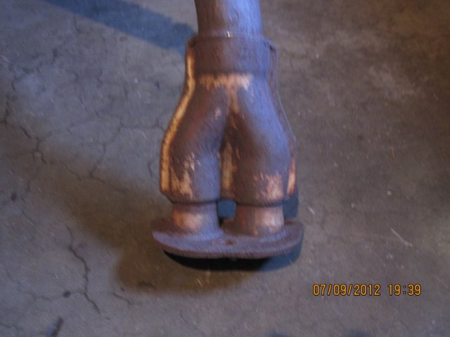

  14. Here's a picture of a typical factory stock 280Z head pipe. I have several and they all look like this.
