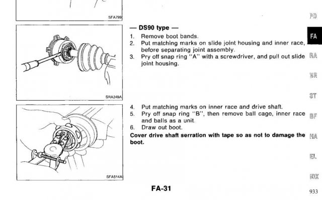

Tool to Remove inner cv joint for z31 axle swap to s30?
NewZed replied to zgeezer's topic in Drivetrain
I gave some bad numbers above, Page 30 is the 4 cylinder axle. Bottom of -31 is the "DS-90" VG30 inner CV. Drawing attached. Aftermarket CV axles can be totally different internally than the Nissan factory axles. Only the parts that connect to the car are the same. EMPI, for example. -
Looks like there's a snap-ring. The FA chapter has a procedure (see link below), jump to FA-30 and -31. Interested in how it works for you. http://www.nicoclub.com/FSM/Pathfinder/1994_Pathfinder/ -
