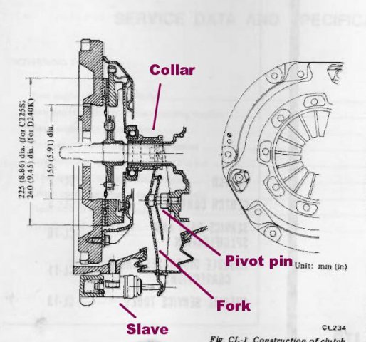

Shortening the slave rod might get you by. The sharper angle might put more wear on the bearing surfaces of the collar and fork but it might work. You said that there was some wiggle room for the collar without the slave cylinder installed. That's what matters most. Make sure that the pressure plate fingers aren't partially compressed without the slave cylinder installed. If they aren't, a shortened rod would be the way to avoid removing the transmission and starting over. To be honest, I might even try that just to know everything worked even before I took it apart to make it right. If I knew that the collar wasn't already riding the clutch. At least you'd have more to look forward to.
You're on hopium. As everyone is saying, there should be some play in the system. If you levered the fork to get the rod in then your slave piston is bottomed and there is pressure on the pressure plate fingers. It's like riding the clutch, you're just going to burn it up right away. The 1" of travel is probably just play in the pedal linkage and master cylinder push rod. On my car, I can reach down and push the slave cylinder rod back and pop it out by hand. It's been working great for about 35,000 miles. Force isn't necessary to put the clutch system together, even with a performance setup. Several people, myself included, have figured out that the key to matching parts is to get ~92 mm from the flywheel surface to the surface on the collar/sleeve that the fork rides on. Assuming a stock thickness flywheel. The slave cylinder, pivot pin and bellhousing mating surface always have the same spatial relationship. Edit - did you put a new bearing on the TO collar/sleeve? Maybe it's not fully seated.
Ben's has another thread on classiczcar. Says the motor came from an automatic car. Does anyone know what happens if you leave the spacer on the end of the crankshaft and install a flywheel on top of it? Maybe the flywheel is lifted an automatic spacer's width.
The brass piece is the pivot for the fork. It doesn't move. The slave cylinder pushes on one end of the fork and the other end moves the opposite way, toward the engine, pushing on the pressure plate springs. It may be that you didn't understand how the system works and have assembled it incorrectly. I got some picture editing practice in, maybe this will help. It's a cross-section so might take some study.
