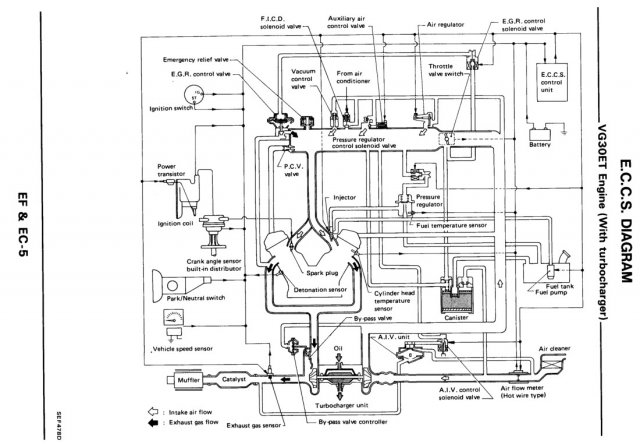

  19. Looks like the Nissan factory setup is before the turbo, not blow-through.
