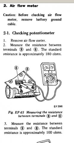

Most people spend days, months or years trying to figure their engine problems out. You are outside the lines with the turbo on the NA EFI system which may be why you didn't get much feedback. It's the "asking for trouble, you're on your own" path. Plus reporting voltages for the AFM and CTS test doesn't really mean anything since the tests describe measuring resistance. I'm not a turbo guy but the fact that you're boosting early seems to suggest a problem with the turbo and boost control (of course)(Edit - had written something else but it was backward thinking). Reporting RPM instead of MPH would probably be more useful too.
