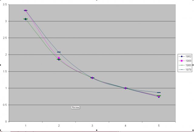

Thanks for the feedback! I've seen your comments on the atlanticz site pallnet (one of the first as far as I can tell), and been through your writeup many times Nigel. I almost have the procedure memorized. I went over to 240SXforums.com and downloaded some FSMs and they show the dual cone 2nd gear all the way back to 1989. The first dual cone appears to show up in 1988 in the 300ZX, which opens up the range for improved synchros. Haven't found any information on the wider gears yet. As for the shorter gears, the C transmssion has about the same first gear ratio as the early 77-79 boxes. So my 3.54 gears should work well, I would guess. I'v attached a little Excel plot I put together just to visualize the ratio differences. Still interested in comments or information, from anyone interested. -

I know that many people have done the Z/ZX transmission bell-housing swap on to the C type transmission to allow its use on the L6. How do they compare after a few miles of driving? Are the gear ratios better? It looks like the 1st to 2nd jump is pretty big, bigger than any of the other 5 speeds available. After you get to 2nd it looks about like a ZX 5 speed. How about shifting performance in general, with the dual cone 2nd gear synchro and newer gear box design in general. I have an extra bell-housing and a line on a 300Zx transmission, and the overall cost and effort looks less than a 5 speed rebuild. I'm on the fence but have time to think about it. Any driving impressions appreciated. Thanks.
