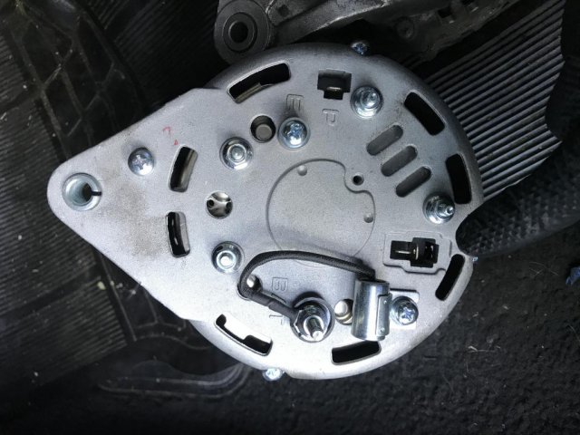

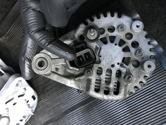

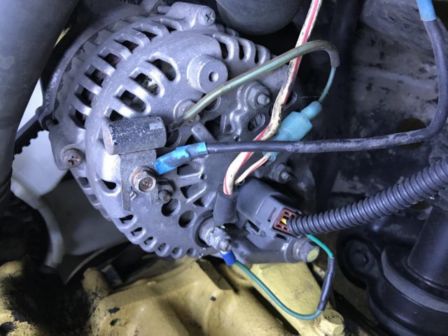

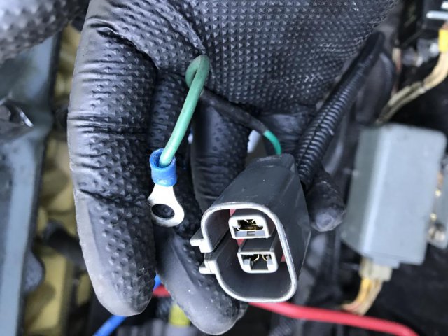

I have a 1975 280z and recently bought an alternator for a 280zx. I went to install it and realized that the wiring and plugs to the alternator were different from what I was expecting. This is the alternator that was in the car at the time of purchase: This is the alternator uninstalled: The new alternator has a T plug, which is what I believe should have originally been there: This the plug that's in the car now: anyone have any idea why the plug might have been changed? And how hard it might be to return things to stock? I found this on eBay: But can I just use that to convert back to a T plug even though it's been rewired? Any help would be appreciated.
