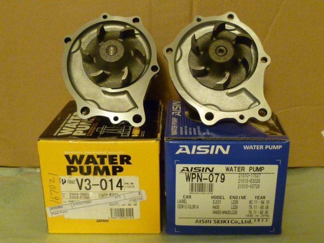

Chris83zxt Posted September 20, 2013 Share Posted September 20, 2013 From Rockauto ... $55 delivered. Sedalia-20120913-00032.jpg Sedalia-20120913-00033.jpg I got mine today and it's identical to the above. I won't be able to test fit it for a month or two. Quote Link to comment Share on other sites More sharing options...

LanceVance Posted September 21, 2013 Share Posted September 21, 2013 Just tried it out, part no: WPN079 has the large impeller and will NOT turn without modifying the timing cover. Good to go! Quote Link to comment Share on other sites More sharing options...

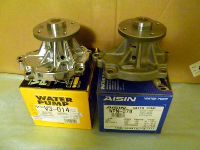

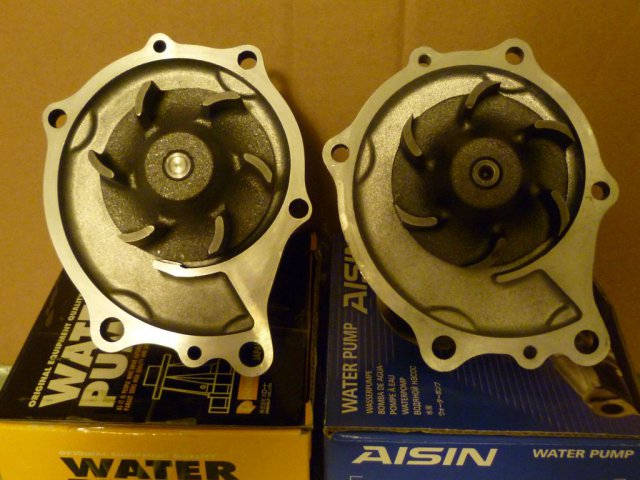

Nelsonian Posted September 24, 2013 Share Posted September 24, 2013 Okay, I received mine (Aisin WPN079) last week and test fitted it by lining up holes loosely into the timing cover and it fits and spins WITHOUT any modification done to the cover. It is only slightly different (extended tab) than my new polished Paraut pump. The new Aisin appears to have had something lightly dremmeled off in two places. Paraut on the left and Aisin on the right. What do I have going on here? Quote Link to comment Share on other sites More sharing options...

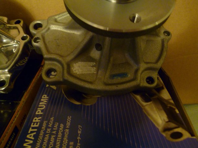

Gareth. J. Posted September 24, 2013 Share Posted September 24, 2013 Kinda looks like the right shape, it's a bit worrying having the grind marks on it though. I hope these are the real LD pumps I've already gone through this once before. Lol. Here's my OEM LD28 pump. Could it be off centre slightly without the studs in? Quote Link to comment Share on other sites More sharing options...
rags Posted September 24, 2013 Share Posted September 24, 2013 Nelsonian, It looks like they used the correct housing but ground down the impeller to look like a gas impeller. The diesel impeller blades overhang the back part of the wheel slightly whereas the impeller shown in your fist picture does not. Quote Link to comment Share on other sites More sharing options...

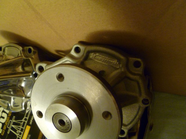

ctc Posted September 24, 2013 Share Posted September 24, 2013 (edited) Did a quick measurement on mine. Aisin impeller diameter measured 2.958" (75.133mm). It would not fit two stock covers I have. Impeller would contact the 7 o'clock area by the water inlet (?). For comparison, my stock pump impeller measured 2.741" (69.621mm) and spun freely. Mine have the grind marks as well. Looks like they ground off a previous serial number or manufacturer name. Edited September 24, 2013 by ctc Quote Link to comment Share on other sites More sharing options...
NewZed Posted September 24, 2013 Share Posted September 24, 2013 What do I have going on here? Is it possible to run the diesel L6 front cover on a gas L6 engine? Aside from the area behind the water pump, what else would be different? Maybe you have a diesel L6 cover. Quote Link to comment Share on other sites More sharing options...
Xnke Posted September 25, 2013 Share Posted September 25, 2013 That looks an awful lot like an Atsugi water pump...witth the markings dremeled off. I have a few that have casting marks in them in that spot that are Atsugi Quote Link to comment Share on other sites More sharing options...
Nelsonian Posted September 25, 2013 Share Posted September 25, 2013 According to this thread (http://forums.hybridz.org/topic/111003-preferred-water-pump-l28et/?hl=%2Bld28+%2Bwater+%2Bpump&do=findComment&comment=1038367) , Atsugi is the parent company of Paraut and was the oem Nissan provider. Could anyone else buying the Rock auto offerings post pics of what you receive. Looks like I will be returning the virtually duplicate pump to Rock Auto. Quote Link to comment Share on other sites More sharing options...
Gareth. J. Posted September 25, 2013 Share Posted September 25, 2013 (edited) Mine arrived today, impeller measured in at 69.5mm, F#$k! Looks exactly the same as yours Nelsonian Looks to me like the numbers have been ground off for a reason, the reason is this is a gas pump. I'll be returning it! Edited September 25, 2013 by Gareth. J. Quote Link to comment Share on other sites More sharing options...
