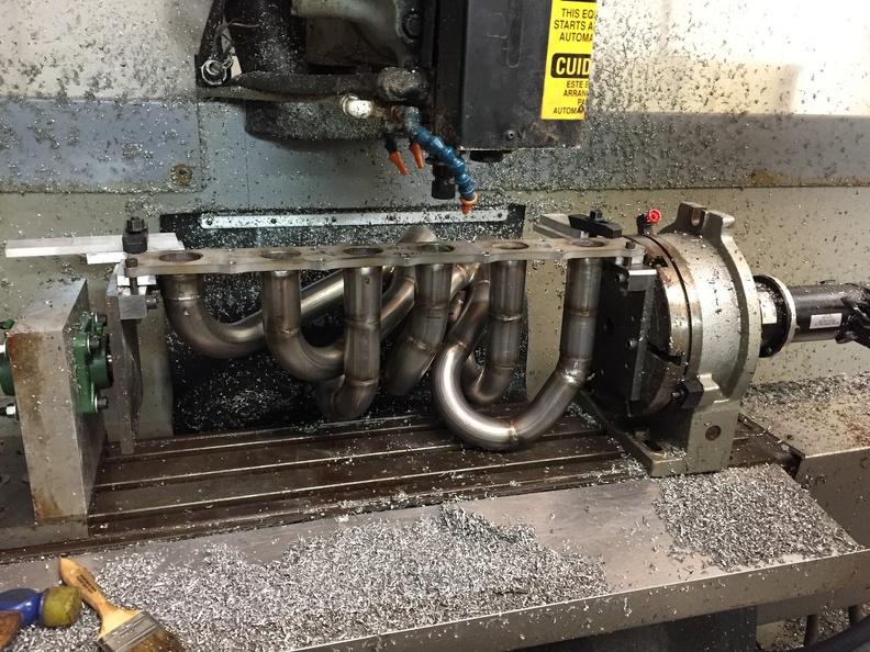

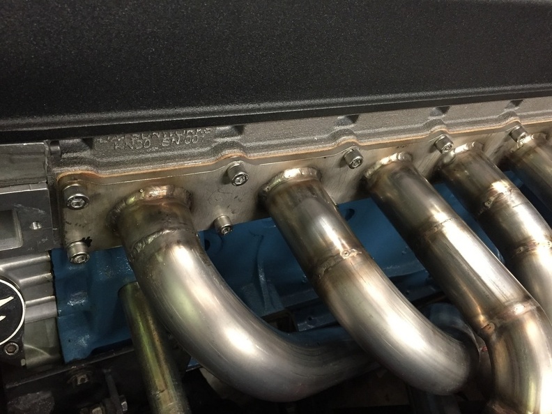

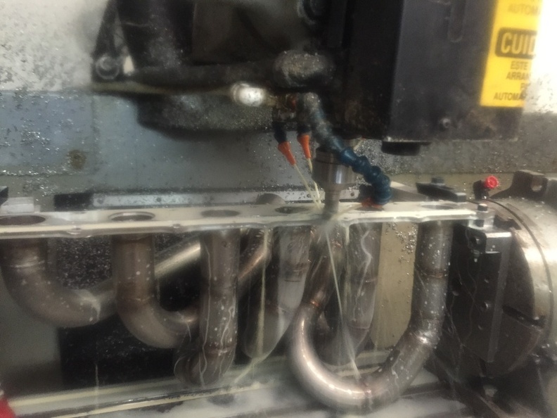

Xnke Posted February 21, 2016 Share Posted February 21, 2016 How much has the header moved after a few heat cycles? The intake noise is awesome. It sounds really smooth too, especially for a "rough start". Can't way to see a plug read and some more tuning! Quote Link to comment Share on other sites More sharing options...

Derek Posted February 21, 2016 Author Share Posted February 21, 2016 (edited) Thanks for the words of encouragement everyone. How much has the header moved after a few heat cycles? The intake noise is awesome. It sounds really smooth too, especially for a "rough start". Can't way to see a plug read and some more tuning! Yea it is really growley. I have a pretty good mike. I'll try and get a Wave file recorded. The Iphone doesn't do it justice. I ended up milling the flange. As soon as I saw it would fit with the doors closed it was a no brainer. Took 6 hours or so because it was not a rigid setup at all so I had to nibble. Made for a nice fit. congrats on not giving up and seeing it through and sharing the process with us in fine detail. any paypal account I can send a beer (or non-alcoholic beverage) to? or perhaps put it towards an adapter plate to give it a 6 speed trans? hehehe Thanks for the thought. Donate to Hybridz if you like. The transmission will not be long for this world. The 6 speed is a tasty looking conversion. Hoke needs to make it happen or others might:) I don't need a 6 speed but I'm a sucker for the "These go to 11" mentality. Which is why I built a twin cam head. I didn't need one of those either. Edited July 7, 2017 by Derek Quote Link to comment Share on other sites More sharing options...
