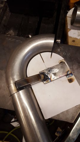

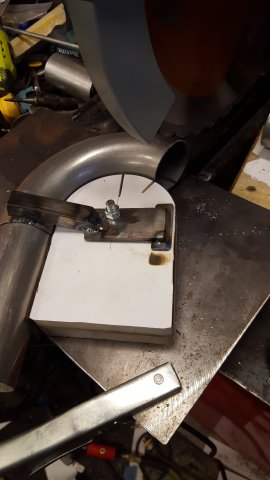

Looking great. You will make so much power, regardless of how long or unequal the tubes are, I wouldn't even worry about it. I made a tube holding jig for my chop saw, nothing fancy, but functional. With a 14" metal cutting carbide blade, it worked pretty well. Once I switched to a nicer 90t steel demon blade, it cut really well. It is a little slower to tighten and loosen nut, but after almost cutting my thumb off, I decided it was worth it.
 20181110_162209.thumb.jpg.76bb1bf2665c225d8ba76ddca7769d2f.jpg    20181110_162205.thumb.jpg.99740cd17c647f6e3ef99bbe21017d19.jpg
That looks like a great idea.  How do you handle different bend radiuses...radiai....however you say it?
Link to comment
I ordered tubing with all the same radius for that project. You would have to swap out the center piece and clamp. The clamp could have been made adjustable I suppose. The center is sacrificial, I just made it out of poplar scrap glued together.
