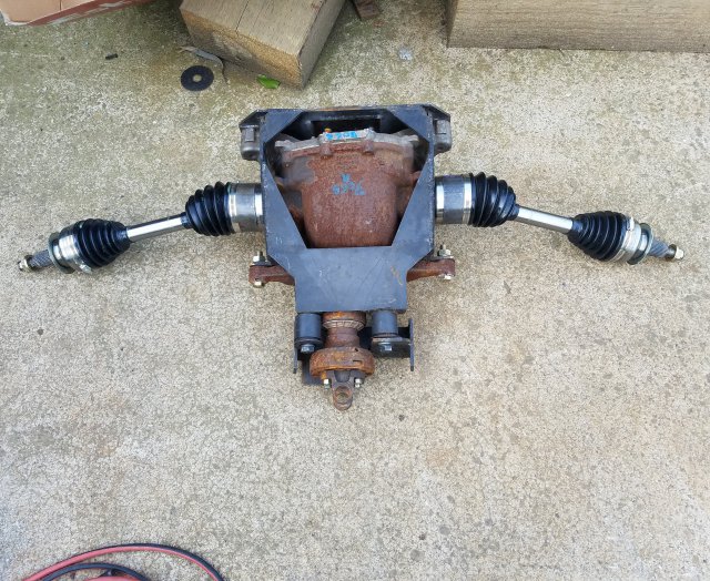

Invincibleextremes Posted March 16, 2019 Author Share Posted March 16, 2019 Assembled them. Planning on putting them in and seeing how short they are, or if they work. Working with another axle manufacturer to make a small batch that i can sell to who ever buys the mount... because i don't want anyone going through what i went through just to get a pair of shafts. Quote Link to comment Share on other sites More sharing options...

Invincibleextremes Posted March 21, 2019 Author Share Posted March 21, 2019 Currently away travelling for work, but before i left, i mounted the setup again to measure axle movement and to see how everything works together and I'll be able to drive the car once i get back and plumb the brakes up. I do have a company making axle shafts from scratch through a member here. Heat treated new shafts instead of cut down junkyard cores. Hopefully those work out quality wise, and that will be the final piece of the puzzle... Quote Link to comment Share on other sites More sharing options...

Invincibleextremes Posted May 1, 2019 Author Share Posted May 1, 2019 (edited) Back in town and working on a couple cradles for a couple guys who want them here and now. Still waiting on the axle shafts. $255 per shaft if bought in bulk and they're made from scratch, and heat treated after. Got my hopes up, because these would be just the ticket to assemble on factory 2015 mustang cv axles. Mind you the factory axles use a hollow shaft on the left side... and these new ones don't. I'll post some pics soon of the cradles and hopefully have news on the shafts. Fingers crossed I'm dealing with good people... would be nice to have 500hp at 4,000 lbs capable cv axles for under $700 a pair... plan B is the $1,300 ones rated to 800hp at 4,000 lbs but thats a good bit more money. Edited May 1, 2019 by Invincibleextremes Quote Link to comment Share on other sites More sharing options...
