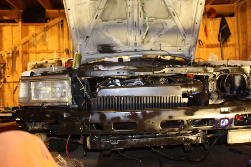

Ever heard of a Nissan Laurel? Well, heres one with a turboed L24E, stock internals, HKS 2mm head gasket, planing ~22 PSI of boost, and ~300BHP+. Engine management is Megasquirt II V3.0, ESAB no slip differential, cut coil springs, racing slicks for track events.
this is a budget build, and total build cost including the car is approx 1300$.
Its not finished until the end of the weekend, this is the "so far" pics. The car will be a road car, but the main point of use is track days. Debut will be next weekend in a drag racetime attacktop speed weekend track day. I hope to empty 5 gear with ease, approx 140MPH, and to outrun many Silvias300ZXskylines both at drag and time attacks, cross fingers and toes ;)
Future upgrades is coilovers and better brakes.
Not a Z, but it is an L28. :icon14:
Cheers!

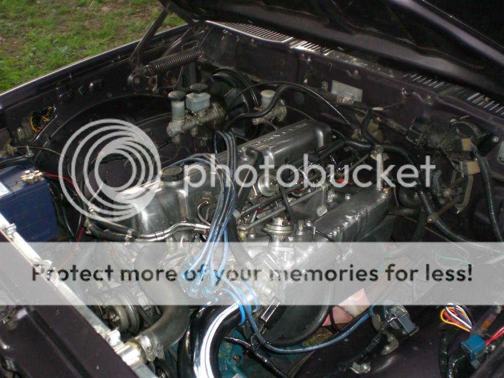

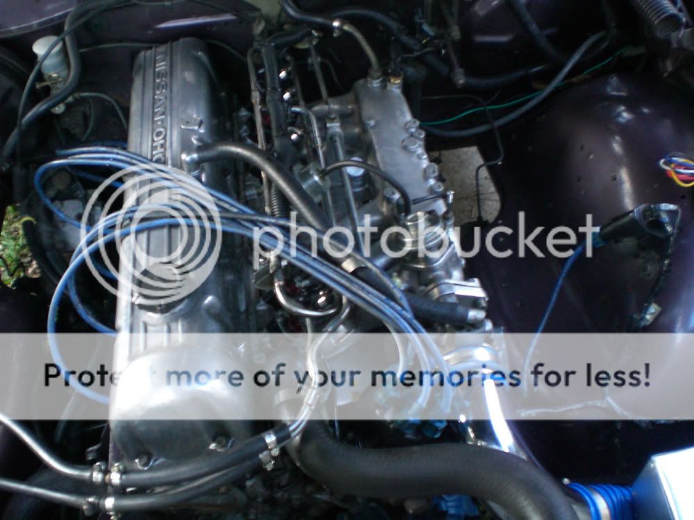

More cedric engine bay photos :cool:
it's a budget build but i'm still proud of it.
I'm open to any suggestions people might have? esp in the heat shield/induction departments as the head was shaved by PO, really trying to control detonation etc... doing alot better with those now :wink:
Thats a neat heat shield... Id be interested in hearing some more before and after opinions.
Thanks:eek:
Its actually just a home fabby job with some tin-snips, sheet aluminium and a ball-peen. I have no idea as to much of the science behind in or how to optimise heat reflection.
I certainly have noticed considerable difference though;

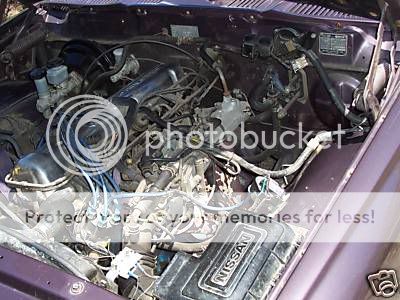

This image is the bay taken by the PO (what was he thinking?!?!) It was reasonably economical but had no guts after 4k :S
after megasquirt install and the new manifold etc etc(not running heatshield and sucking from bay) it had alot more power (seat of the pants guess) but i could hear pinging after 5k depending on temp etc. even with my fairly conservative timing.
the induction and sheilding are only a couple of weeks old but i certainly noticed it has made a difference, i've been able to run alot harder than before without hearing any det moments *touch wood*.
MS tells me i've dropped ~10*C in intake temp w00t
The manifold still gets a bit warm down near the head because the sheilding is VERY close where the extractors+sheild+manifold meet, i suppose thats why alot of guys cut the webbing out?
Interestingly it's started running rich on the same tune as before, i would have expected it to be lean with cooler air? i need to address my MAT compensation i guess(?)
I chose to go with an airbox rather than piping because of the rarity of the car and not wanting to cut up the nosecone. it sucks from behind the lights where there's a fair bit of connection with the outside world, plus there's a big gap in the fender cavity there which is also continuous with the real world (ex-vivo :P):hijack:

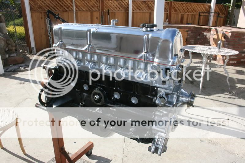

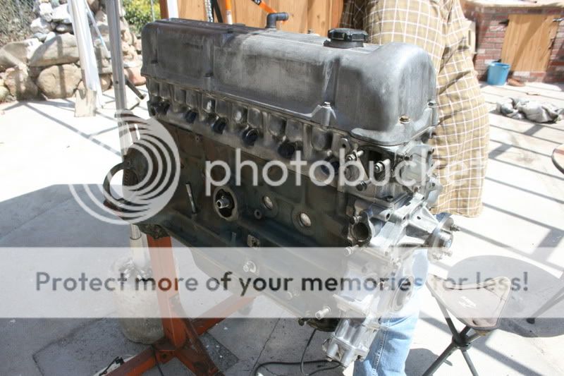

i'll bite in this thread... here is my engine but not in the engine bay yet... car is still at the paint shop...
before....
after gaskets replaced and paint with polished valve cover...
Remember to cover those ex ports too! DIrt can go in them just as much as the intake ports. I would hate for that pretty motor to have scored cylinder walls :)
