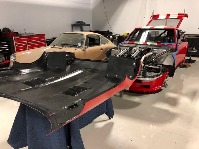

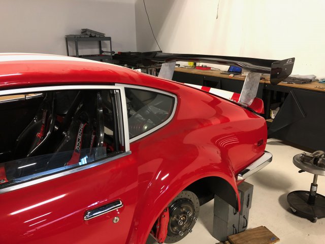

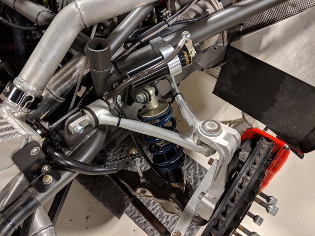

markrolston@mac.com Posted July 27, 2019 Author Share Posted July 27, 2019 this forum has really slowed down but I thought I'd make a brief update since it's been a while. I've been driving the car, slowly tuning the setup. You can imagine that a completely custom chassis is going to have it's own pros and cons to discover and tune. Right now just finishing up installing a new set of springs and 2-way adjustable shocks. We are adding some rock shielding to the engine back- the open wheel wells are cool looking but invite all kinds of rocks into the engine bay. Also working on adding a wing to the rear for better aero. 1 Quote Link to comment Share on other sites More sharing options...

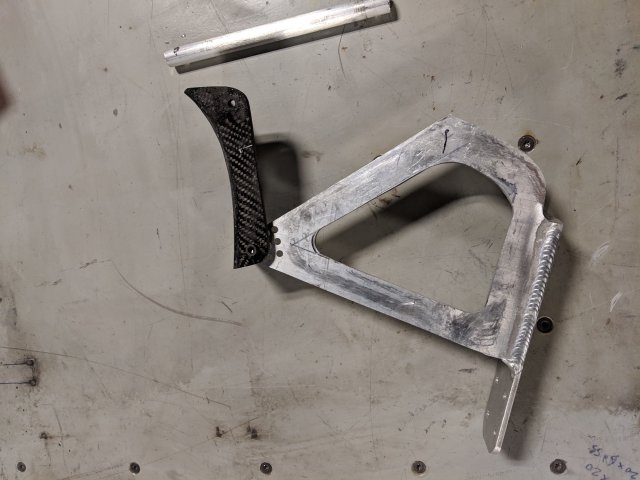

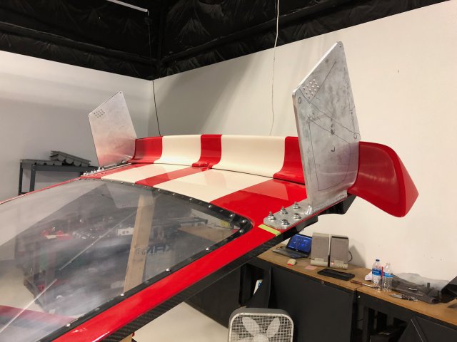

markrolston@mac.com Posted August 12, 2019 Author Share Posted August 12, 2019 small update. cutting down the wing mounting to a minimal form. I need to choose whether to leave it bare aluminum or paint it black. Any opinions? Quote Link to comment Share on other sites More sharing options...
Neverdone Posted August 12, 2019 Share Posted August 12, 2019 If you're gonna polish the aluminum, leave it bare. Otherwise, paint it. Quote Link to comment Share on other sites More sharing options...
260DET Posted August 16, 2019 Share Posted August 16, 2019 Wings and attachments should be black on a S30. Quote Link to comment Share on other sites More sharing options...
EF Ian Posted August 21, 2019 Share Posted August 21, 2019 Black for me. Quote Link to comment Share on other sites More sharing options...

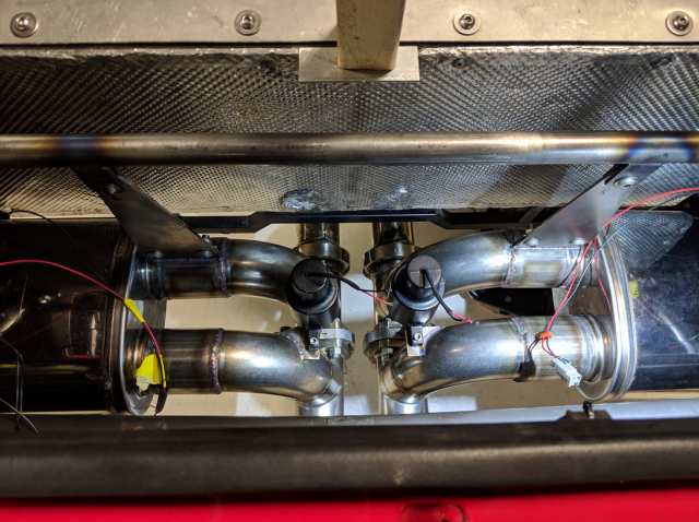

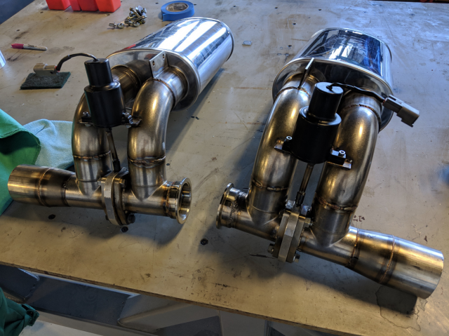

markrolston@mac.com Posted August 24, 2019 Author Share Posted August 24, 2019 I'm just finishing replacing the mufflers as well. The original ones were too heavy and didn't do much sound attenuation. These sound much quieter when the valve is shut. That whole area in the back (between the fuel cell and tail lights) will get insulated to keep wiring and the fuel cell cool. I did a drawing where the back panel of the car is a mesh steel instead of the carbon panel for cooling. The lights and license plate remain as is over the mesh. It might be really cool looking and definitely useful to vent hot air from the diff and exhaust. Right now we're hunting down an oddity about the brakes. The rotors are huge (14") but the car has never had enough bite. They should be a lot better given the hardware. So we're experimenting with pads and talking with WIlwood about the Master Cylinder size versus the calipers to make sure it's set up right. The wing is down and it's right now just polished aluminum. I'll drive it like that for a bit to decide whether or not to paint or anodize it black. Quote Link to comment Share on other sites More sharing options...
EF Ian Posted August 25, 2019 Share Posted August 25, 2019 Nicely designed. I am understanding this right? They are straight pipes when the valve is open but with it closed the exhaust is forced to go through a double pass muffler? Quote Link to comment Share on other sites More sharing options...
