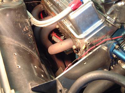

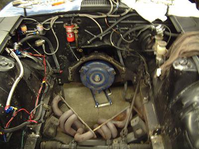

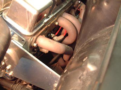

Well I happen to be looking at the stored photos on the camera and found some that hopefully will work for you. Take a look below. The one of the engine compartment, shows the mid-plate attached to the frame rails and also you can see the tabs I made up front that I bolt the front motor plates to. You want to use two bolts when bolting them, so you will not get any pivot / rocking motion. I hope these help. John -
