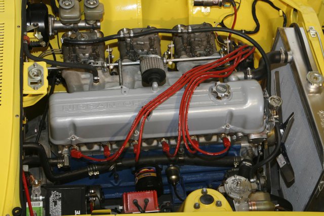

  4. I think I got the greatest joy from the engine build. We took a 280ZX 2.8L block, bored it out .5mm, then added an E31 head with a mild cam with a 270 duration and a .45 lift. We added headers, a nice custom fabricated exhaust and 42DCOE's which were rebuilt in Rex Chalmers in the US. We had a custom radiator that has the exact dimensions and fittings for the 240Z. Many hang too low when placed into the 240Z. Most of the pieces under the hood were plated. It's by no means perfect, but it's nice for a car that actually gets drive and see some time at the track. We did go with the 5 speed. It's an early one with the closer ratio gears. We rebuilt it, added a lightened flywheel and a stage 2 clutch. Right now it has the Pertronix Ignitor, MSD 6AL, and the stock distributor. The crank damper was rebuilt. Nothing very aggressive, but it's fun as heck to drive. Right now I'm dealing with some low RPM issues which seem to be tied to the issue of vacuum advance not working with the Webers. Hopefully that will be sorted out soon. We've done a few photo shoots with the car. In terms of future upgrades, we're going to focus on getting the interior this Winter. There are a few bits and pieces that need to get plated and then re-installed. Once I have a load of parts to bring to the place that does my plating, I'll likely swap out those pieces.

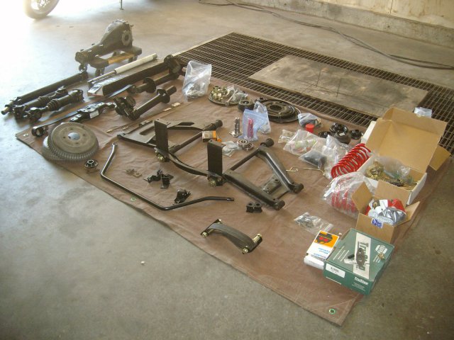

  5. When we did the suspension, we removed all the bolts, cleaned them, bead blasted if necessary, then had them re-plated (cadnium. We also powder coated the suspension pieces after media blasting them. I used the BetaMax conversion hubs to add a Subaru R180 3.7 ratio LSD. I did not do a rear disc brake conversion.

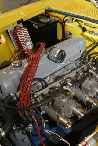

  11. yes, this is for the vacuum advance for the distributor. I guess that wasn't clear. I have what is termed a 'street' cam grind, triple Webers, and the stock distributor with Pertronix / MSD 6AL. Even with proper (meaning dyno-tuned) jetting, I'm getting a little bog around 2,000 RPM. Everything points to the timing advance. The right thing to do is likely an Electromotive crank fire set-up with coil-packs. I think there's a MegaSquirt equivalent there too. I was just hoping for a simple (and cheaper) fix.

  15. how is everyone handling vacuum advance with triples? I have a manifold that has three vacuum ports that go into a collector and then to the vacuum advance on the distributor. this improved the low RPM bog, didn't fix it all together.
