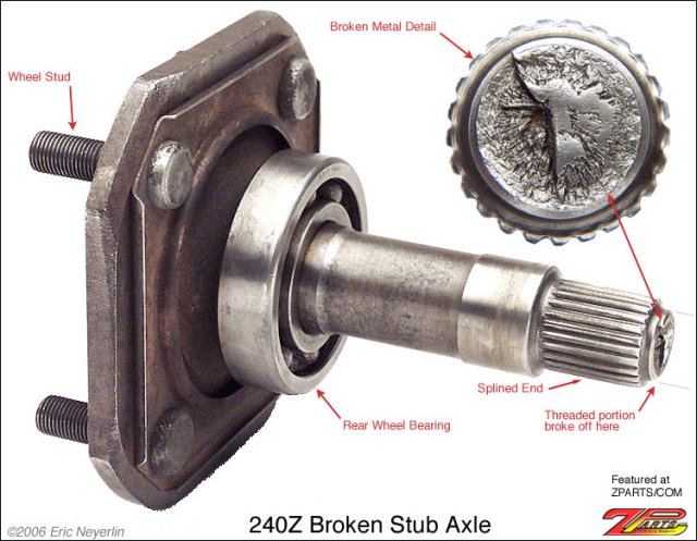

There are other weak points to consider in your build plan. The stub axles typically fail in two places, the tire mounting flange breaks off or the axle breaks where the threads meet the splines on the axle. See pictures. The flanges are easily warped which can cause problems with disk conversions. I had this problem when I did the Modern Motor Sports 240SX rear disk conversion. My rear brakes were dragging due to the warped flanges wobbling against the pads. Tried machining the flanges, but they were were too far out. When my Z was stock the driver's side stub axle broke while pulling away from a stop sign. Very loud pop when it let go. The solution to the above problems was the stainless steel stub axles now available from Modern Motor Sports. No more problems. http://www.modern-motorsports.com/stub-axles.html

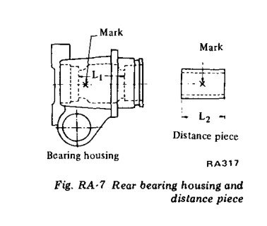

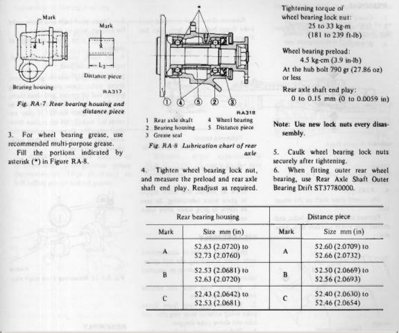

I did not measure the spacer. I don't know what the length is supposed to be anyway. Does anyone have that measurement? See my post above. I think the seal is seated because when I have the flange installed without the nut it turns free enough. When torqued down, the nut pulls the entire assembly together causing an improperly seated seal to rub. Been there many times. Adding more torque on the nut usually does nothing. Pull the axle and use an old bearing as a drift and tap all around the seal/bearing to seat it. Listen and you will hear a change in sound when the bearing is fully seated. The second I put the nut on and torque it a bit is when it gets tough to turn. When torqued down, the nut pulls the entire assembly together causing an improperly seated seal to rub. Been there many times. So I'm looking looking at a spacer replacement? Not as long as the PO didn't change them or the hubs. See post above for instructions. Is there a difference between the length of spacers drivers side to passenger? Not unless the PO changed the hubs. Never seen this on unmolested 240Zs.
Be sure that the grease seal and the inner bearing are completely seated. You may have to use a an old bearing as a drift and tap them into place. Also see: http://www.atlanticz.ca/zclub/techtips/rearwheelbearings/index.html http://forums.ctzcc.com/viewtopic.php?t=7307&highlight=&sid=a22e20007238292ecb090456230f708a Assuming there were no issues before changing the bearings, the inner spacer would only be a problem if a PO had mixed up spacers somehow. See atch picture from the FSM
