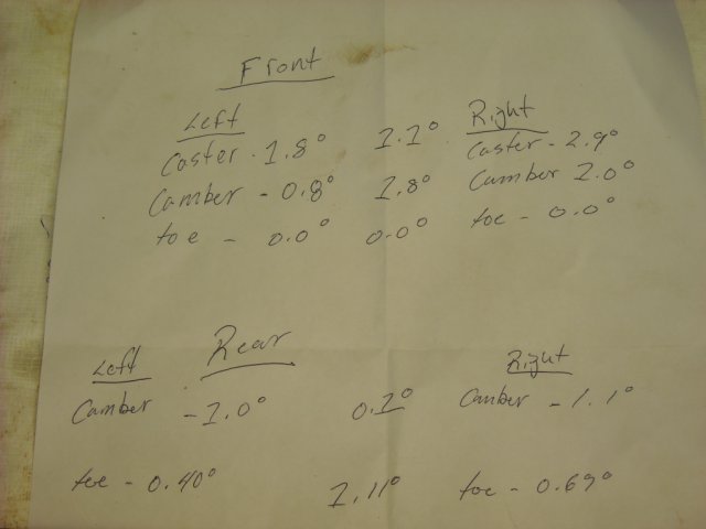

Alignment numbers
grannyknot replied to grannyknot's topic in Brakes, Wheels, Suspension and Chassis
74_5.0L_Z, thank you for your help, just checked and the top of the strut is definitely behind the ball joint so I have some pos caster. I know not to go back to that alignment shop, can't do simple arithmetic or tell positive from negative. -
Alignment numbers
My worst caster setting is neg -2.9* and I have to make that at least pos 4.0* Can anyone tell me what 7 degrees of movement translates into in inches? -
Alignment numbers
All 4 T/C bushings are new rubber, I wasn't sitting in the car when the alignment numbers were recorded so that might work out well for me. If the car isn't sitting perfectly level is the only option corner weights? -

Alignment numbers
Okay, I've been starring at the numbers that the young guy at the alignment shop wrote down and he has made some mistakes in his arithmetic when showing the difference between sides and ALL of his numbers are negative, no positive numbers, I went back up to the shop and confirmed with him, so these are the real numbers, Front L R Difference Caster - 1.8* - 2.9* - 1.1* Camber - 0.8* - 1.0* - 0.2* Toe 0.0 0.0 0.0 Rear L R Difference Camber - 1.0* - 1.1* - 0.1* Toe - 0.40* - 0.69* - 0.29* So as I understand it the front caster is weird, wrong and I'm not sure what to do about it. I need a smidge of camber on the left front and I would be okay for a street car, same for the rear camber and the rear toe should be equaled out. Does this look like I'm interpreting this properly? Thanks, Chris -

Alignment numbers
Thanks guys, Jon, so you are talking about moving the crossmember to the right or body to the left while the bolts are loosened? All they gave was the hand written sheet, this was a local alignment shop. I will take the car down to Whitehead Performance this week, they deal almost exclusively with older Z cars. Strangely enough I think it handles well up to about 70 mph then it starts getting a bit squirrely, maybe I've just gotten use to it. Thank you -
Now that the build is finished http://forums.hybridz.org/topic/122185-m-powered-z/ I took the car for an alignment and here are the numbers, EDIT Please see post #7 for the real numbers. The shops printer was down so they wrote them out for me, the rear looks pretty good but what could account for the big differences in the front? The springs are Eibach lowering with Illumina shocks, no provision yet for adjusting camber or caster. Thanks, Chris
