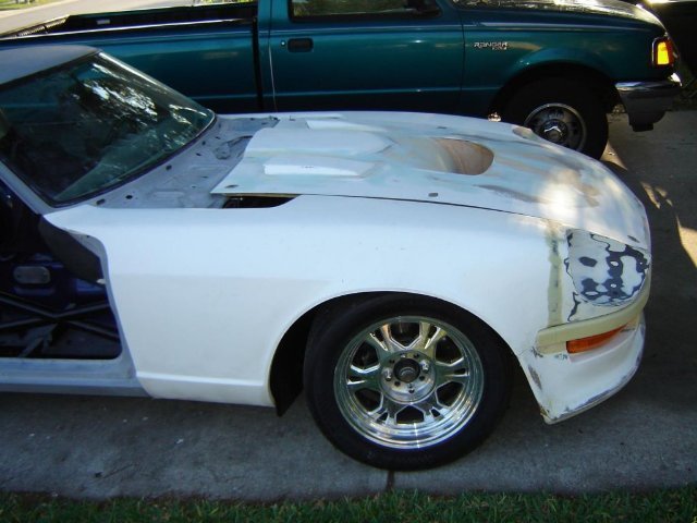

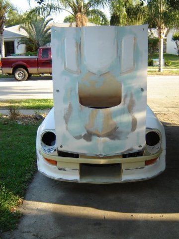

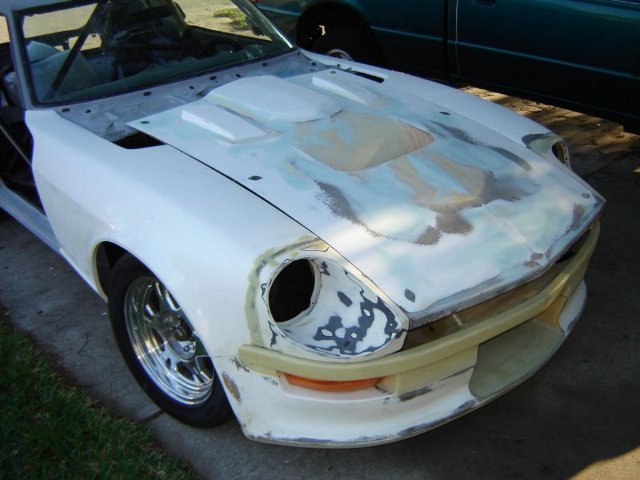

74_5.0L_Z shamelessly emulates Terry Oxendales Hood
74_5.0L_Z replied to 74_5.0L_Z's topic in Body Kits & Paint
Craved, I am not 100% certain which way air will flow through those vents. They are a little forward of the cowl and outboard of the centerline of the car. They may or may not be in the high pressure area of the windshield base. Somone should do some wind tunnel work to find out. My main concern was to control the air coming through the front of the car. The hood that I started with (SubtleZ Cowl) had two holes like the later 280Z. I could have just filled them in, but I decided that additional vent paths for heat might be a good thing. So, I acquired the two small vent covers from Reaction Research and blended them in. -

Thanks guys. I will line up the dzus fasteners when I finally secure them to the hood. Yes, those are factory FRP buckets. They are secured to the SubtleZ fenders using epoxy resin w/chopped glass filler (West Systems 406), the factory fasteners, the inner sides have been filleted to the fender using the same resin / glass mixtures, the seam was then ground down and refilled with epoxy/ glass, and finally the seam was covered with epoxy/ S-glass cloth. If it shows after the paint job I will be rather upset, but it would be a lot of work to change then now. -

I used a closed cell foam from Michigan Composites. It isn't affected by the resin or other chemicals. I used two different thicknesses 1/4" and 3/8". The 1/4" is easily shaped into curves, and the laminated 3/8" gives good stiffness. The foam is yellowish in color. Yes, I did the SubtleZ rear flares as well. -
As the title says, I borrowed an idea from Terry. I hope that my car will someday look as good as his. I still have a bit of work to complete before its ready for paint. I post updates as I go along.

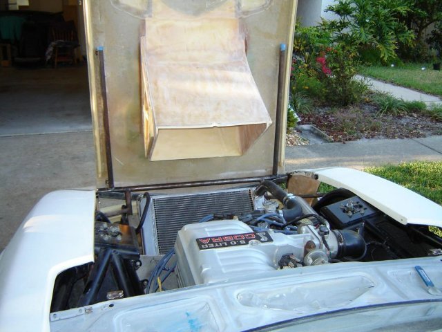

Aerodyn wind tunnel results!!!
74_5.0L_Z replied to bjhines's topic in Windtunnel Test Results and Analysis
Quote: Originally Posted by Daeron could this have been it? This was from 74_5.0L_Z's photo album here on hybridz.. but looking at it a second time, it s hard to see if it prevents that much air from traveling under the car.. obviously his setup forces it through the radiator, but the point is (seems to be?) to avoid it pushing below the car entirely, and leaving the airflow no choice but to go through the engine bay and then out the engine bay vents. I dunno if I am right nor not, but that was the car that *I* was thinking of regarding your comment, there, stony.. What you guys have not seen yet is that all the air that goes through the radiator comes out through the hood (I have shamelessly emulated BlueovalZ's hood). I have also closed in most of the gap between the top of the bumper feature and the bottom lip of the hood. I'll try and take some pictures tomorrow and start a separate thread. I don't want to pollute this one more than necessary. The radiator opening is sealed to the radiator with rubber gasket. The ledge between the bottom of the radiator and the front of the air dam is 18.5" wide by 21" deep. I'm hoping to take advantage of the high pressure area in front of the radiator. -
