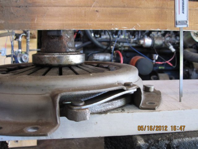

Here's a picture I took of a working clutch, at rest. On your leak-down problem - there are two seals in the MC; one to build pressure and one to keep fluid in the reservoir (check a later FSM, like 1978, to see a better diagram). I don't think that the MC is meant to hold pressure like a brake MC. It's meant for short time frames. Could be though that you have a leaky one. Quality is poor these days. Did you disassemble and clean it before installing? Did you check the slave dust boot for fluid? Leaks will be contained in the boot. -

Good luck. That picture was from BE-10.

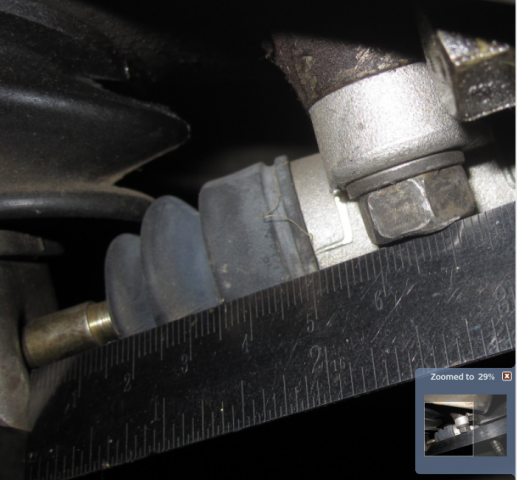

Curious, how long is the old bolt compared to new? You could compare while in the slave cylinder, to the new one. I'd guess it's longer and somebody had a short collar problem. I wrote a bunch about checking parts then went back and saw this - "So I just installed a new stock LuK clutch kit in my Z, new slave, master, T.O. bearing and springs, and pivot ball.". Are you sure that pivot ball is correct? That would cause problems if it wasn't. That 0.4 inches of travel though, is still key. If something was bottoming out mechanically, that might stop slave piston travel. But if there's nothing stopping it you need to get it to spec.

Interesting. My thought process just opens up the spec. for that measurement down to 82 mm. Thanks for sharing. I think that your mechanical parts are fine. 92 mm has worked for many people and it's probably no coincidence that your new pressure plate gives that number. I'd go back to that 0.4 inch of travel from your hydraulics. You can probably explore that further with the slave cylinder hanging. You were getting less than 1/3 of the stroke you should have been getting.
